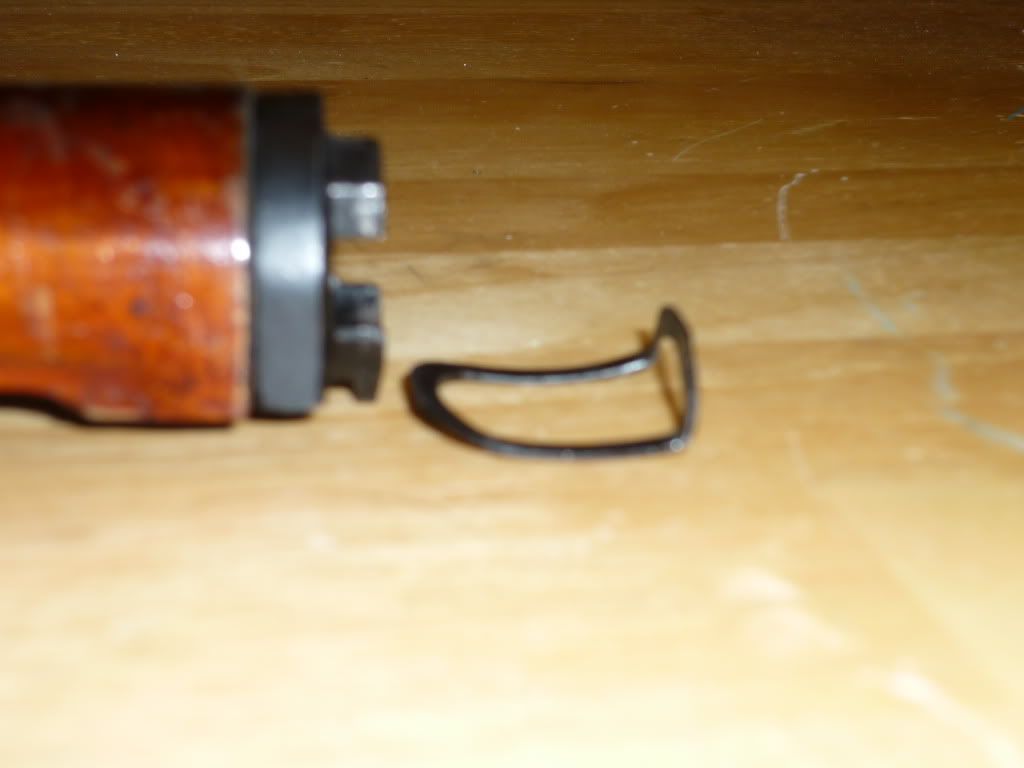

Posted: 7/27/2012 12:41:39 PM
I'll take a pic on Monday...im in Vegas baby! you do have to make a 90 degree bend on the spring...still pretty simple and quick.

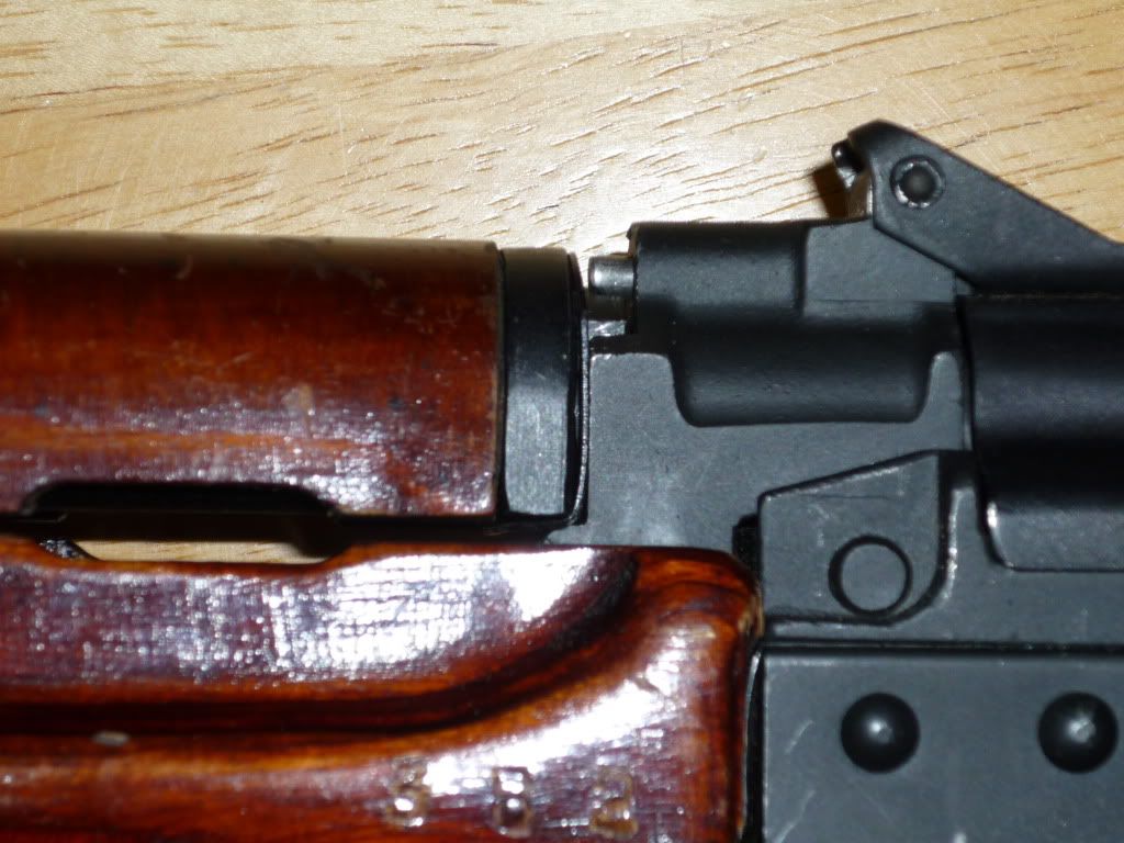

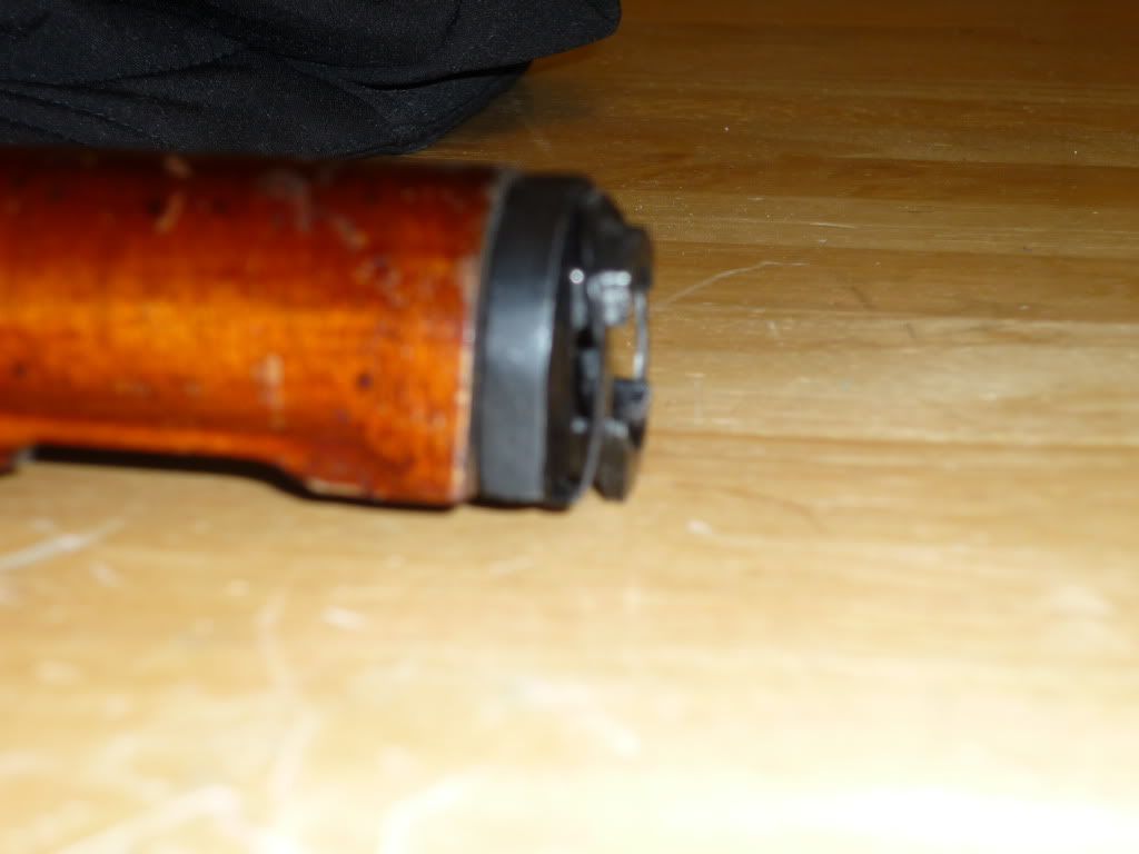

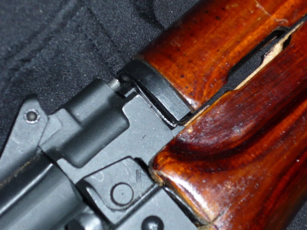

Posted: 7/31/2012 10:55:15 PM
Here is the spring on the gas tube. It fits rock solid. I actually need to use a screw driver to pry the little detent out from over the gas tube. There is no rubbing of the carrier and the rife has worked flawlessly.

Haha, I was actually just thinking to myself, "I wonder if that guy posted those pics he said he was going to do on Monday." Clicked the thread and BAM! Thanks for the pics. Glad I kept all of those springs from my Saiga conversions.
