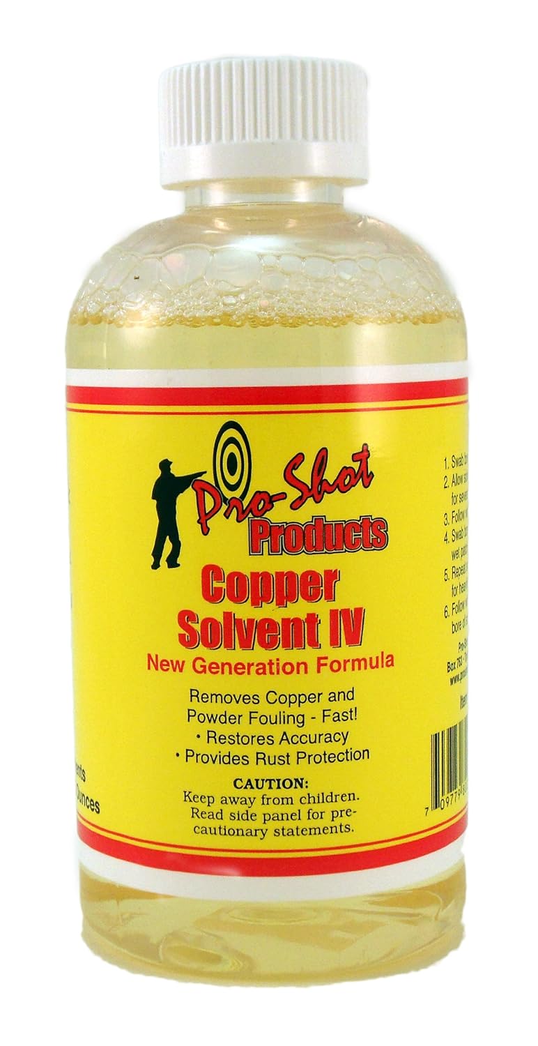

http://www.amazon.com/Pro-Shot-8-Ounce-Copper-Solvent-IV/dp/B001F0M2WS
This stuff is great.  No ammonia and gets copper and powder fouling.
If you shoot with a QPQ/Melonite/Nitrided barrel - they tend to pull copper off the jacketks and get a lot of copper fouling until they wear in (which takes time since QPQ is so hard).  This stuff gets it out in a few minutes and at the same time, is not aggressive enough to harm the gun like Sweets 7.62 and ammonia based cleaners.
