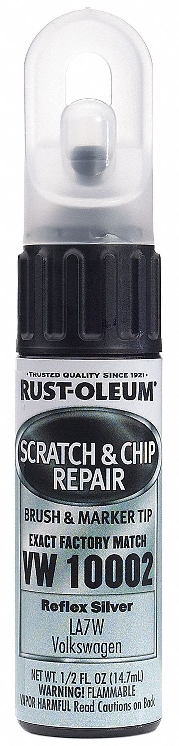

Go to Walmart and pick you up a paint pen in the automotive section. The ones used for fixing rock pecks in your car. The paint is very durable and it should come with both a brush, and a fine pen point. The numbers are relatively small so keep a damp cloth handy. If you get outside of the lines immediately wipe the paint, because that shit is tough as hell to get off. Take your time and it should turn out great.
I've used this same technique for color-filling lettering and such. The automotive paint in these pens is a lot harder to work with than nail polish or something similar, but it's far superior in looks and durability.
Here's the kind I use....(ignore the color, just illustrating the product)...

Thanks y'all. I may try a mix of using both the auto paint and the nail polish techniques, I have one of those pens for the vette, and the car is white, so I already have the right color and everything. But I think the credit card and a little enamel thinner would help clean up outside the lines very well.
