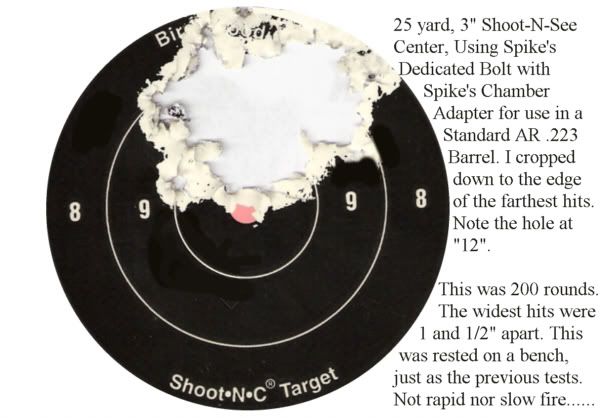

Posted: 6/30/2009 12:29:14 PM
[Last Edit: 8/11/2009 11:17:29 PM by SpecOps-13]
Test: Spikes Dedicated Bolt Assy Converted With Their Chamber Adapter For Use In A Standard AR (.223/5.56) 1:12" Twist, 20" Barrel
I made it to the Range Last Night. Tried to get there late enough so it'd be cooler,,, NOT.
I didn't adjust the scope during these tests, I just used the setting "As Is", Where it was set for the Ciener Unit. That's why the hits are a little high.
The lower I was using had a Very Light Hammer Spring in it, the first round went bang. then nothing, nothing, nothing. I put the Ciener Conversion back in to verify it wasn't a problem with my Assembly of the Spikes Chamber Adapter on the Previously Dedicated Spike's Bolt. Same results with the Ciener. Changed the spring out, Put another Shoot-N-See Center up and began shooting.
I fired, resting on the bench at my established test rate trying to keep all things equil with previous sessions. This time I fired 200 rounds, the farthest hits didn't change with the last 50 rounds, So the Chamber Adapter that Tom sent from Spike's added to their Plated Bolt is actually more accurate than the best Ciener Conversion I have when fired in the same way, at the same rate.
The assembly functioned Flawlessly. The O-Rings make for a snug fit into the Upper Receiver. Meaning that you can remove the Upper without the Bolt Assy falling out. That's Nice in itself. Clean-Up was a breeze, the Plating really makes it easy. I'm not done testing yet, still a few Tricks Up My Sleeve.

Posted: 6/30/2009 1:45:13 PM
[Last Edit: 6/30/2009 1:48:57 PM by MrMONEYman]
Originally Posted By SpecOps-13:
So the Chamber Adapter that Tom sent from Spike's added to their Plated Bolt is as accurate as the best Ciener Conversion I have.
So there is no noticeable difference in accuracy that the o-ringed chamber adapter makes, right?

Posted: 6/30/2009 6:50:41 PM
[Last Edit: 7/28/2009 8:29:10 AM by SpecOps-13]
MrMONEYman:
"So there is no noticeable difference in accuracy that the o-ringed chamber adapter makes, right?"
That's somewhat true. Here is what I found.
Their Plated Bolt is as accurate as the Best Ciener Conversion I have being fired at a slower rate than for these tests. I have 8 Cieners that were compared prior to my testing.
It will be very interesting to have your results added using M1S Parts. I'm doing my shooting by resting myself on the bench for some added stability. i load the mags to 25 and fire at a moderately fast rate to come up with an average accuracy. Same recover and shoot as I mentioned before. Not rapid fire and not slow fire. My own human error has something to do with that. I'm not as steady as I was 30 years ago, My eye sight isn't 20/15 now either.
We'll be able to relate your results better if you fire each time under similar conditions with each setup. Especially the rate of fire. You don't have to shoot exactly the same way or number of rounds as I do, just shoot the way you do each time. We can compare the 3 different rifles and get a pretty good idea of how well you'd be shooting mine and visa-versa. This will be a great way for us to compare the accuracy of Dedicated Spike's vs Dedicated M1S and the 1 in 9" and 1 in 12" . Very Cool.
The reason I shoot so many rounds for grouping is to get an average of My Ability, the Conversion/Rifle Capability and the Ammo's Consistancy. I'm using all Wal-Mart Federal Bulk for all the tests, but it'll be fine if you use something different. Doing all of this we should be able level your ability vs mine and get a good comparison of the Rifles and Conversions and the Dedicated Uppers.
