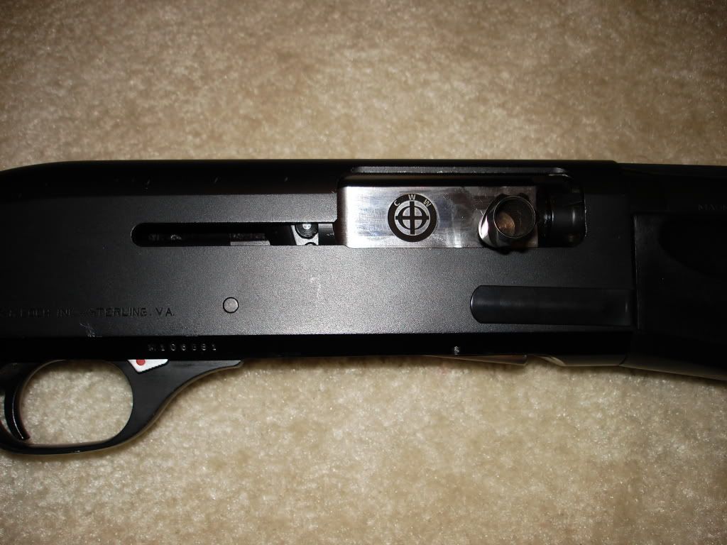

02NBMFormula  [Member]
11/7/2010 4:56:33 PM
Try and find one of the HK imported M1 Super 90's, that way you dont have to machine the bolt in order to ghost load it.
Then as everyone else said, weld the lifter (jeff @ crums does a great job at this)
8 round tube (nordic or briley)
bigger bolt handle (nordic or progressive machine if you can find one)
that should get you started if you want to do more then mill the bolt, bigger safety, bigger bolt release, trigger job etc.
here is a pic of mine
