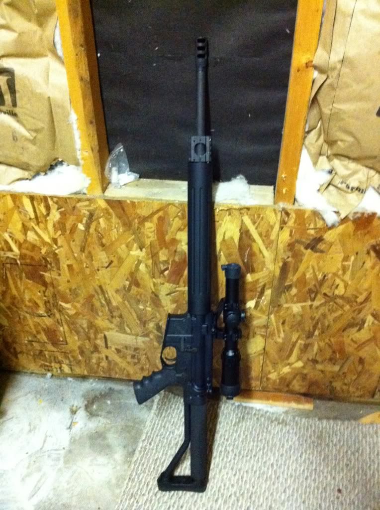

jtielke  [Team Member]
10/18/2010 11:19:10 PM
20"
This one.
No
1 in 8" 55 gr. inside 200 yards, 68 gr. for longer range.
Rolling Thunder
Rifle
DPMS Carbon Fiber
Standard DPMS, but an adjustable one is on my short list of things to buy next

rgvwheeler  [Team Member]
12/11/2010 12:10:26 AM
just finished it I think
DPMS upper& lower
RRA 2 stage trigger
20" 1:9 olympic barrel
rifle length gas
dpms free float handgaurd which was also FREE
Miculeck comp
Ace skeleton stock
Millet DMS scope
YHM picatinny gas block
this thing runs great almost no recoil. The miculek comp is real loud, but it works really well
