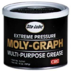

Short and simple? Moly Wheel Bearing Grease

lambo  [Member]
3/18/2012 12:53:26 PM
I bought this jar in 2002. I've used it on every AR barrel I've installed since then and just about anything else I've used grease for.
Pumpkinheaver  [Member]
3/18/2012 10:02:09 PM
Originally Posted By lambo:
http://i457.photobucket.com/albums/qq293/badka2ma/2012-03-18_11-31-17_618.jpg
http://i457.photobucket.com/albums/qq293/badka2ma/2012-03-18_11-39-21_859.jpg
Same stuff I use.
