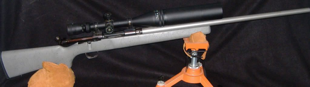

Shilen SS Match Grade Select 28" 1-14 twist .22-250 Ackley Improved.
Too long/heavy to shoot off-hand but velocity is just under 4K fps and far zero is just under 300 yards.
Hand load w/VMax turns groundhogs inside out.
Prolly not the answer you were looking for but an op to show off my varmint rig.
