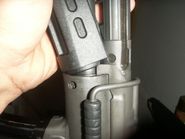

How do I get these #^%$&^% things on my C93.I get that the little lip on the rear fits into the circular recess around the barrel but I have these metal wings from the metal thingie that holds the carrying handle that protrude down into the area and the hand guard wont fit over them.Are they supposed to be bent in more?Or am I missing something?

notch the handguard

That's what I just did about 2 weeks ago to fit a slim handguard on my Vector V93.Took about 30 seconds with a dremel.Bending in the metal wings/arms/legs won't work––-that's the 1st thing I tried before I took the dremel and cut off about 1/4" of the inner lip on the handguard.

The slim handguards don't typically fit with the carry handle in place. The carry handle works with the wide handguard. As everyone else said, relieve the handguards to clear the carry handle.

This was a common situation at HK back in the early days when I ran customer service. Our advice to customers was to remove enough material from the Slim HG ring to clear the tabs. If done carefully, you wont see the mods when the HG is in place. No biggie.
