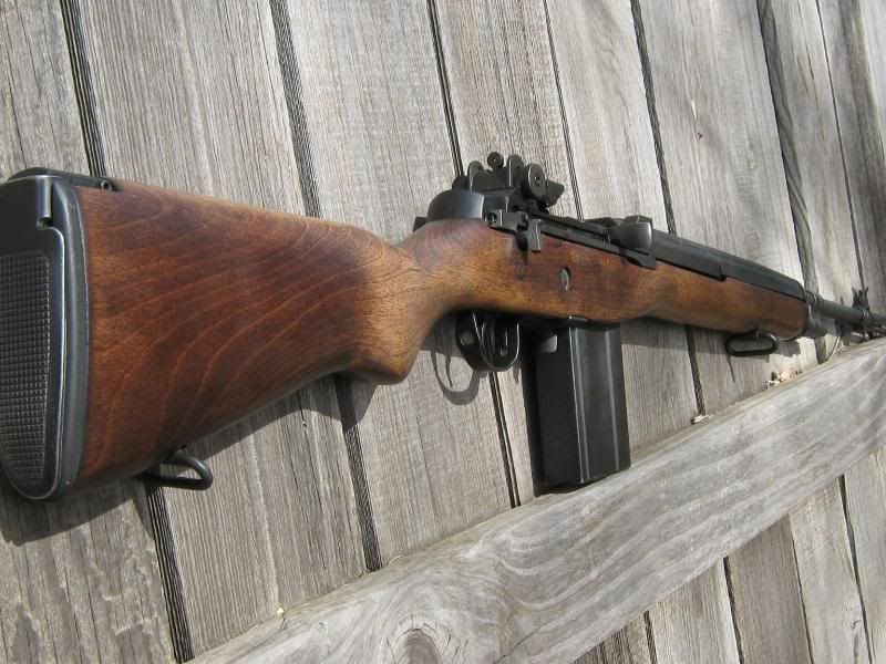

 Finished building my CMP M14 kit
panzersergeant  [Life Member]
4/19/2012 12:45:16 AM
It is mostly Winchester with an HRA trigger group. Took it out to the range today for a shake down run and she didn't skip a beat. Ran 100 rounds of surplus 7.62 through it and she cycled like a champ.
I put a fresh coat of boiled linseed oil on the stock when I got home from the range. It really brings out the wood grain of the walnut stock.

Originally Posted By jkysmrf:
How much can I get one done on the cheap. I mean - I can always upgrade in the future. Im talking shootable
CMP "A" grade kit: $600
SA Inc receiver: $600
USGI bolt: $250
USGI barrel: $300
Your looking at around $1700 just to get in the game.

Where did you get your receiver, barrel, and bolt and who screwed it together?
The 1963 Winchester barrel and bolt I bought off of Gunbroker. The SA Inc. receiver I bought from Champion's choice. I had the barrel mated to the receiver and headspaced by Darlington Gun Works.

I'm curious what Darlington hit you for their work. I've had two CMP kits sitting around for a couple years, and two LRB consecutive #'d receivers for about 5yrs. Might be time to get off my ass and get them built.
4/20/2012 6:30:23 PM
Originally Posted By lapster:
Sweet stick!
To install the barrel and headspace the bolt they charged me $55.
