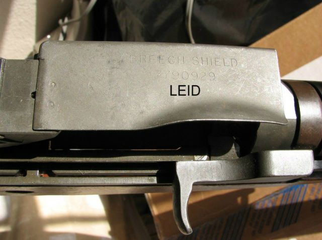

I am very surprised to see that amount of muzzle flash going thru your can. Might be ammo related; little/no flash retardant. Sound reduction appears VERY good. I get zero flash firing LC M80 thru 762SD but with the standard 22" barrel. Put a USGI BFA Breech Shield on to control blowback if it will fit with your scope mounted; it works. If not, Schuster does help and it slows the moving parts down. HTH

I've been trying to find that shield but could only find it with the firing blank adapters. I guess you can just get the shield. It looks like it wont fit with my scope mount unless I modified it.
I stand educated; did not realize the Ti cans did that. Never seen one fired. The breech shield is just a couple bucks when you find them. But it fits in the stripper clip guide which you look to be using for your mount. Go with the Schuster; it will help.

I checked the sources I had for individual M3 Breech Shields; sold out. Cheapest complete M12 BFA kit with M3 Breech Shield is RAparts@$20; new.

The shield will reduce blowback the most. The gas plug will help but you'll tune it to run suppressed and it won't run unsuppressed. I suppressed my scout but was disappointed in it so I sold it to fund a better suppressor platform.

http://i9.photobucket.com/albums/a72/leid/M14/M3BreechShield.jpg

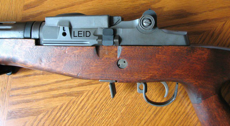

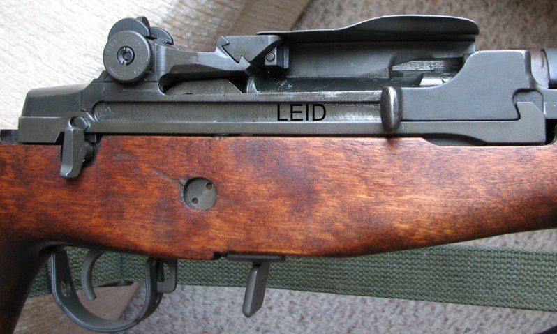

Hey Leid, what does the breech shield look like on the other side of the receiver (left side)? I want to see how it will affect my Bassett mount as that pretty much makes contact with the whole left side of the receiver.

Here is the Schuster. Once I found the first setting that would cycle the action with LC M80 BALL unsuppressed, opening the valve just one click would not cycle the weapon at all with suppressor attached. It worked very well on slowing down the speed of the moving parts/cyclic rate but there is still quite a bit of blowback. The threads should have been made as fine as possible for a more precise setting IMO. But there may have been a design restraint there I do not recognize.

So you just tighten that with an Allen key to find the sweet spot. I guess I'll have to remember the clicks or just swap out the gas plug when shooting suppressed.
That hold is where the bassett screws into and the notch is we're grooves on the mount fits into. Doesn't look like much I would probably have to cut/grind it off so the mount fits flush on the side of the receiver. And you said the BFA mounts onto the stripper clip guide?

Yes, the Shield has a lug with a spring loaded retainer toward the bottom to lock it in the guide. A little work with a Dremel is all it should take; maybe weld the Shield to the lug more solidly for strength. There are also some scope mounts that have a large shelf which does a pretty fair job of blocking blowback.
