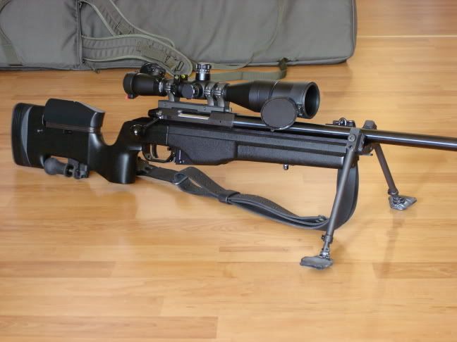

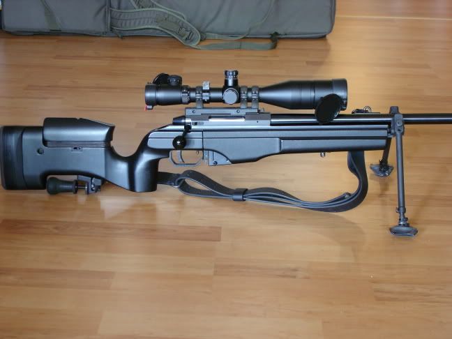

This is what comes in the box with the gun.

Just fondling mine and returning it to the safe. no scope yet. Love it! Pod and brake were expensive but they are nice. Don't think I'll use the brake much on the 308 except to annoy people at the range....some day.

TRG Warne

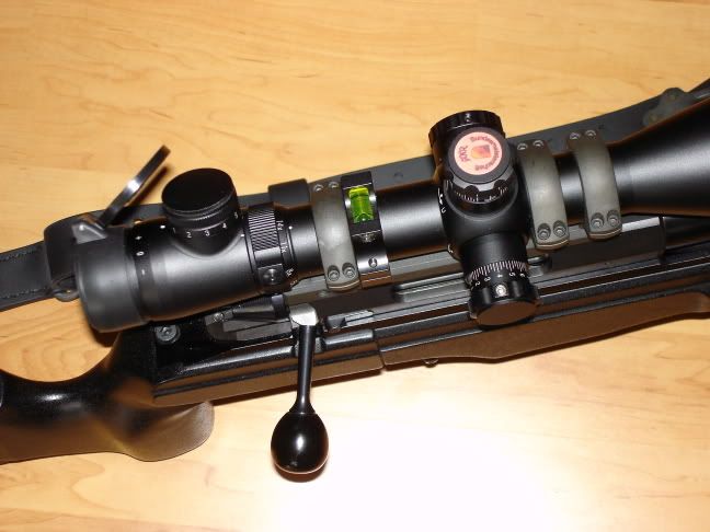

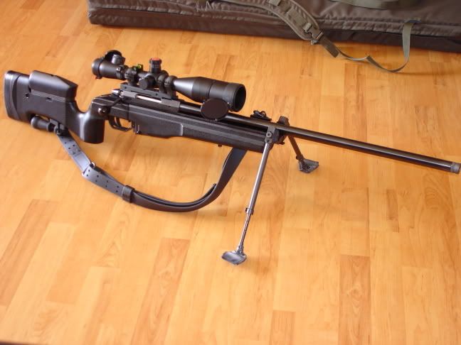

from_HH  [Member]
3/18/2008 6:38:44 AM EDT
Originally Posted By Bujesus:
Any truth to the rumor that the green stocked rifles have a more durable stock than the black stocked ones? Doesn't make much sense to me....
NO
IIRC, I saw a pic of a green TRG whose stock broke in half as the result of a drop. I think it was a pic posted by either Fist Of Freedom or Septic Tank 13.
Thanks. It made no sensse to me that it be true. It is just another interweb rumor I have heard repeated by several. Why is it that the black ones are generally cheaper? More of them? People just prefer the green?
I never noticed the difference in price. I personally prefer the all black TRG's, but who knows why they might be cheaper. Another thing to consider is that most of the people that I know who bought green got a "kit deal" included. By kit, I am referring to the muzzle break, bipod, etc. My black TRG came with no such accessories, but when I purchased it (on gunbroker from Bachman's in Dallas area), it was going for the exact same price as the similarly equiped green ones on gunbroker.
There are, in fact, TWO black TRG versions available. One is exactly like the green one, only with a black colored stock of course. The other one is the "economy" model. I've visually compared the different versions and so far only found the following differences:
The green rifle and its black counterpart are fully parkerized. The "economy" version has a blued barrel. What is more important, the "economy" rifle lacks the small slot at the muzzle end of the barrel, at the 12 o'clock position just behind the muzzle threads. This slot is for centering the military back up iron front sight or a mount for an Ansch├╝tz target sight. Maybe that's the main reason for the difference in price. There might be more differences (i.e. different material for the stocks? - just to fuel the above mentioned rumors), but I didn't notice any.

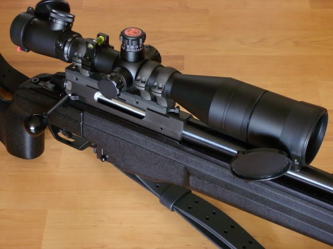

As I intend to use only the scope with my TRG-22, I spared the extra cost for the BUIS prepared rifle (and the sights themselves for that matter). I never missed that option so far and I'm quite happy with my rifle (Ah, another chance to post my pics again).
You can clearly see the difference between the blued barrel and the parkerized receiver + scope mount
Speaking of the scope mount, I really liked the SAKO Optilock rings with their self centering plastic inserts. Eases up mounting of the scope and protects its finish as well. Scope is a Leupold Mark4 4.5-14x50mm LR/T M1 with illum. Mildot reticle.

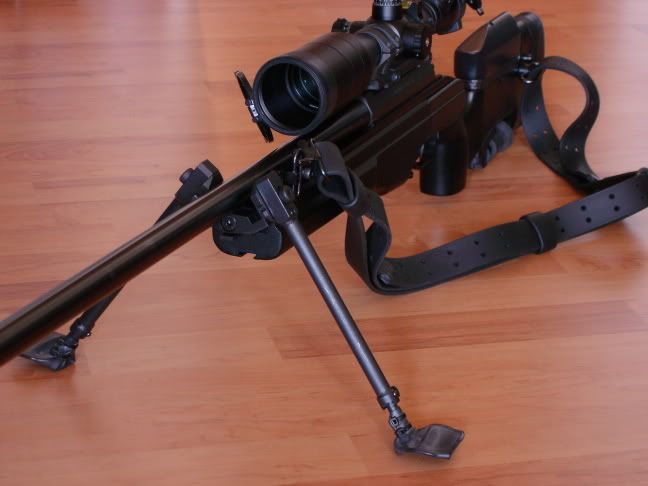

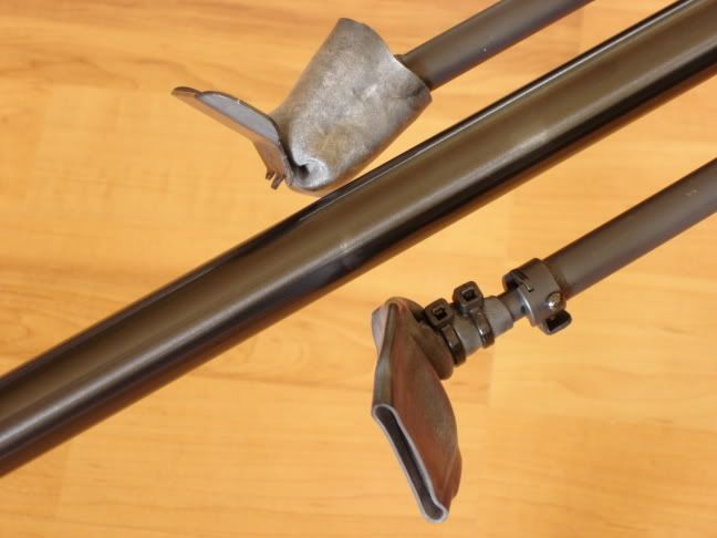

+1 on the costs for accessories. The bipod is worth saving money for it and is the next best (and easily transportable) thing to a well set up sand bag rest. The plastic spacers for the stock (butt and cheek piece) are ridiculously expensive. I cut up an old leather belt to make some spacers for the cheek piece.
I've tied some pieces of bicycle inner tubes to the bipod feet. This prevents them from marring the scope's finish, when the bipod feet are folded backwards. The tubes are easily peeled back when using the bipod on a rough surface.
