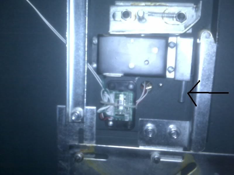

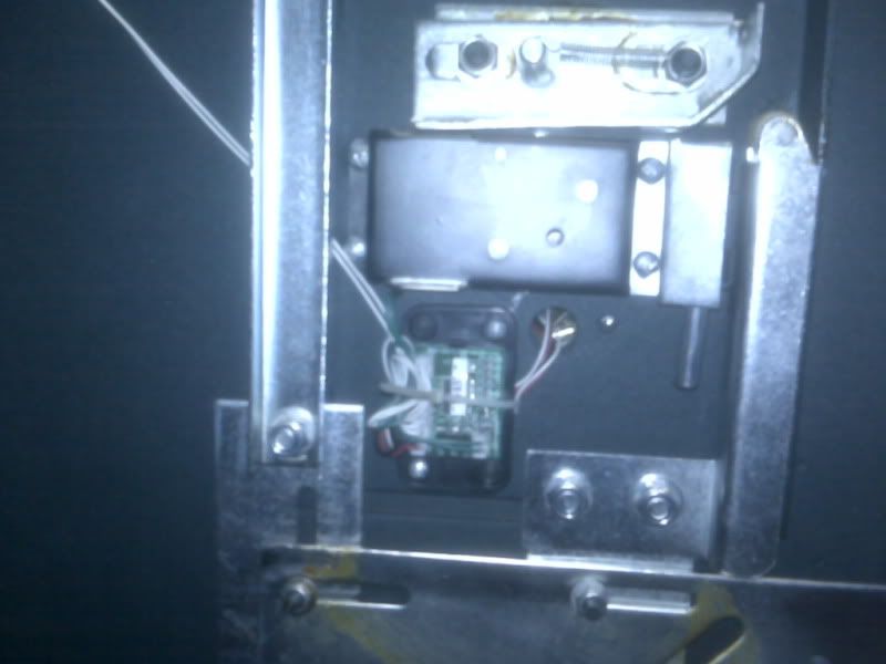

I talked with the Sentry customer service and a technician and they told me that I might need to replace a solenoid, pictured below as the black rectangular thing for about $50. He asked me to send him pictures but has not gotten back to me. Assuming it is the solenoid, should I replace it or hire a locksmith to see if he can fix it?
Can anybody see what the problem is? I have it in both the locked and unlocked position from the back in the pictures.

A solenoid would make sense as it would do the actual mechanical work of retracting the locking bolts once the electronics recognized your combination. Or vice versa, it would extend the locking bolts in place when closing the safe up.
There might be a way to check the solenoid with a multi-tester but that's beyond my capabilities.

I fixed the problem with help from Sentry tech support. Turns out the bracket on top of the solenoid (the black box) was stuck, there is a pin that retracts from the solenoid to lock the bracket in place and this keeps the safe closed. Fix was putting a flat head screw driver between the bracket and the solenoid and the bracket was able to retract back. In the picture below the arrow is pointing to where I put the flat head to make the bracket move to the right.
