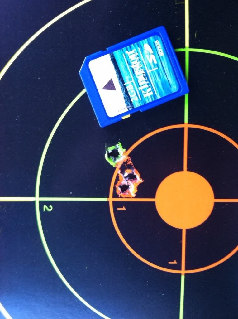

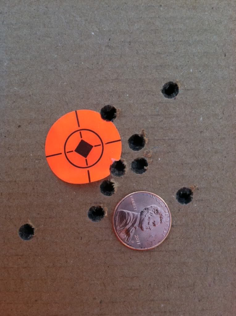

3/10/2012 9:07:31 PM
this was the group a few weeks ago 50yds
zoomworms  [Member]
3/10/2012 9:09:47 PM
after Sig changed barrel 50yards 55gr federal
zoomworms  [Member]
3/10/2012 9:10:56 PM
69 gr Privi
FiremanFrank  [Team Member]
3/10/2012 9:17:55 PM
Very nice. I am glad they took care of you.
FreezinSig  [Member]
3/10/2012 10:44:35 PM
Excellent!
