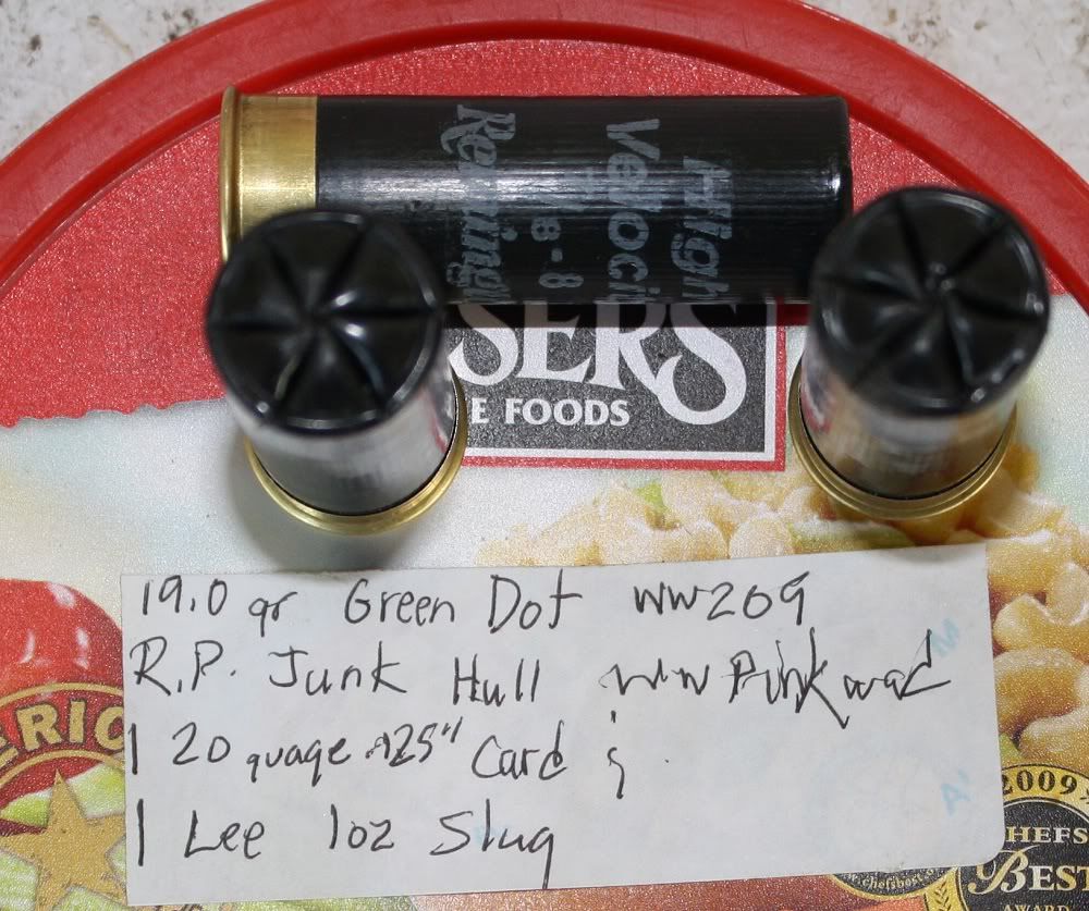

Does anyone have a photo of what a Lee 12 gauge slug loaded looks like? I am going to load some up, but wondering what the crimp should look like.

Thanks for the quick reply. I tried loading some with the Lee data and got a serious roll crimp.
KB7DX  [Team Member]
5/21/2012 10:56:40 PM
My slugs look like normal shotshells. The ones pictured above aren't right. The "load column" in those is too short hence the open tops and swirling. Wait one and I'll post up a pic of mine with the data..
ETA –– pic
Load column. I use the fiber disc to increase the load column height for proper crimps.
I have loaded Lee slugs using Red Dot and Green Dot as well. I used the HS-6 in my last batch just to use it up.

RIPRonReagan  [Member]
5/30/2012 8:51:30 PM
Try using a .125" 20 gauge filler card at the bottom of the wad, under the 1oz slug.
You'll probably experience better accuracy too since the filler card will help the wad come off the slug quicker after it leaves the barrel.
I use the Winchester pink wads and 19 grains of green dot for my 1oz slug loads..
5/30/2012 8:56:23 PM
Picture taken just now:
