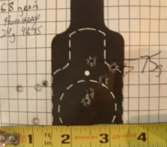

My chrome 1:9 Bushmaster 16" will shoot 68 grain Honadays into under an inch at 100 with 24g IMR 4895.
The same gun does 75g Hornadays just as well over 23.5g IMR 4895.
If you drop a 68 and a 75 grain Hornaday on the table you almost need to weigh them to tell them apart.

well, I got my 68gr BTHP's. Still debating whether to go buy some varget or use what I got which is IMR4895. Looking at Rock71's target makes me at least want to try the imr4895. Anyone else use or have used imr 4895 specifically with 68-69gr bullets in an ar-15 platform?
