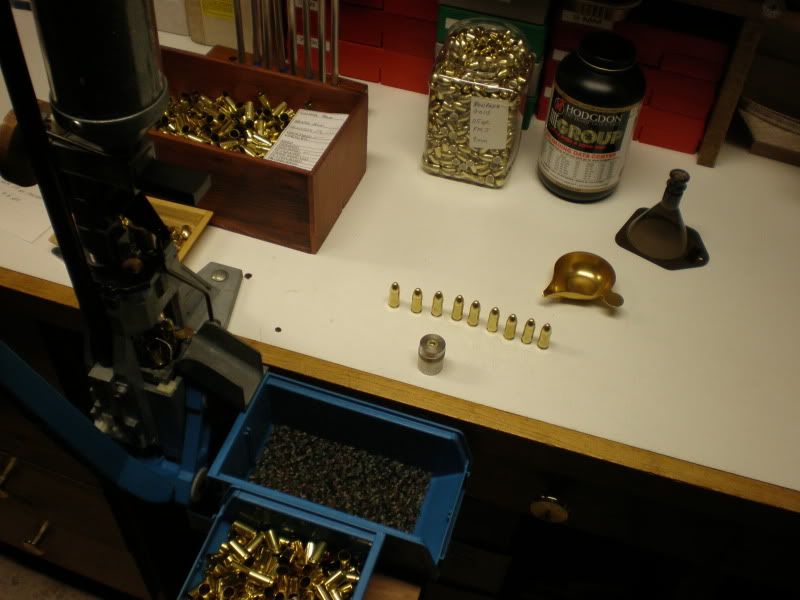

I just found a pretty sweet load for Ranier Arms 9mm HP 115 gr bullets. 4.5 gr of titegroup gave me about a 2.5" grouping at 30 yards. I'm very pleased.
Anyone else had success with 115 gr 9mm slugs and Titegroup?

I've used 4.2gr and 4.6gr of Titegroup under 115gr Winchester FMJs. Works well.

My standard 9mm load is a Precision Delta 115gr FMJ over 4.4gr of Titegroup. Runs well in all my pistols and my subgun.

Same here except I use 4.2 gr of Titegroup.

Use about what everyone else says, one thing I have noticed about TG is the small amount of powder it takes. One pound goes along ways and the price is reasonable. $15.99 I can buy it for locally. Happy shooting

Montana Gold and 4.4 grs TiteGroup has worked well for me.

115gr. Berry's and 4.5 gr, of Titegroup is my load.
I am REALLY careful to avoid a double charge, though. All too possible with TiteGroup and 9mm.

The only caliber I use titegroup for is .45LC (plinking loads). It fills VERY LITTLE of the case, so use caution. Of course, becasue of the strength of 1873 replica revolvers, most smokeless powders fill very little of the .45LC case. However, I find Titegroup to be just about the LEAST positionally sensitive powder I've ever tried. Plus, like you said, it is cheap.

I'm still on my first pound of titegroup and I think I've loaded 700 .45 and 400 9mm. Reloading for pistol is the goods!
