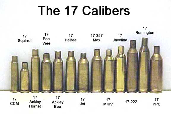

RareBear  [Member]
5/19/2010 7:20:39 AM EDT
20VarTarg 20KillerBee 20Tactical 20BR 20Dasher
17pos(Predator on steroids),17Predator,17Rem,17Furball
