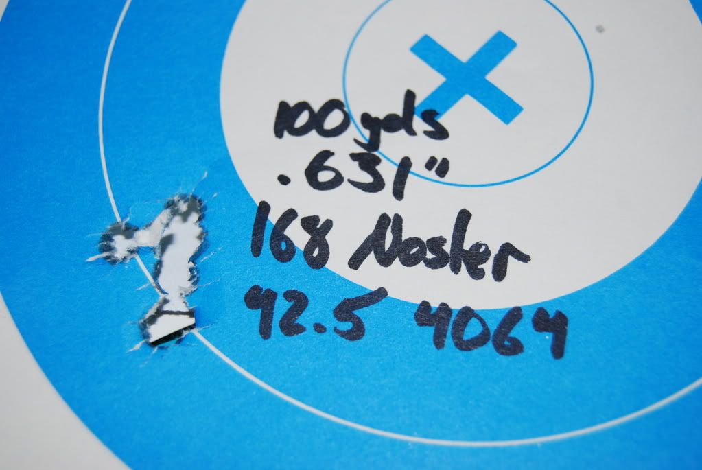

quantim2  [Team Member]
2/16/2009 6:03:41 AM EDT
I have found that 42.5 gr 4064 behind a 168 gr Nosler BTHP works well. I haven't gone over that yet, but I will be trying 23.0 gr my next range trip.
2/19/2009 9:09:24 AM EDT
