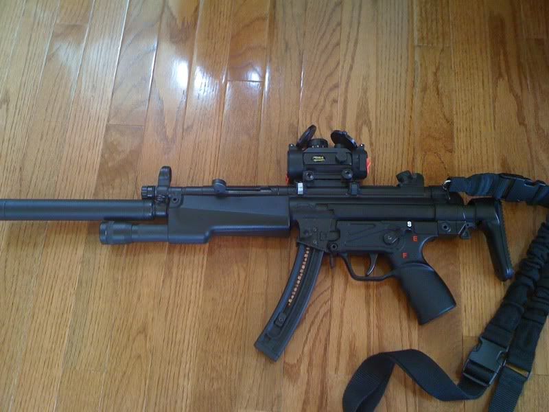

I wouldn't suggest doing that. I scribbed an x into mine, then just drilled it out. The thing's hollow. You don't want to go too deep though. Take the laser and measure the part with the threads, that's roughly how deep you want to go with the big bit. After that, measure the part where the batteries go, and drill with a bit, (I can't remember what I used, but I do know it was guessing followed by moving up in bits before I got it right. (It's bigger, but not much then the battery tube. When you put it in, you quickly see how much bigger you have to go, I did. I used a bit that matched the outer diameter of the shell they sent with the laser for the first drill hole. You don't go too deep with it. I dremeled the shell back to the threads, and then dremeled a ring around the center of that. (for a glue/grip area.) I then took the cocking tube and measured inside the hole and dremeled a slight ring inside it. (I used a cut off wheel that I'd worn down a lot on another project, it fit inside well.) Then I coated the ring with epoxy, (I don't think it was needed, s it's pretty hard to press that shell inside because of those bands on the sides, but I did it anyway) It fit inside well, then I just used the same steps the other guy did in the gen one mod, you know, the oring for compression, the file at the bottum for the suppessor, ect, .... Oh, and you do not have to worry about the front site blade, it doesn't get near the hole you drill, and the battery tube at the end won't come near the charging handle either.
Just make sure you hold that cocking tube tightly, like with a leather glove wrapped around with a pipe wrench, or some vice grips or something before you drill, that thing will beat your knucles to death if the bit grabs. But trust me, that fake cap is really thin, so don't push hard with the drill press.
I got a spare cocking tube from ATI so when I go in the woods here, I can put it on and leave the laser home, (damn stupid laws here)
I think I've only got pics of where I started scribing the front cap, after that I got bogged down in the, "nope, wrong bit," and " now how do I get this part stuck in here" and forgot to take the most important pics. But, you can go up to the pic thread, and run back just a few pages, and find mine there. check the pic out, and then compare it to the gen 1 mod and you can see how ti looks just a bit different on the end because I didn't cut off the fake button. I guess it won't hurt to do that, if you want to, but I didn't.
Just drill, fit, and work it in. And get a spare cocking tube for when you can't have a laser

If you zoom in and look at the end, you maybe can see what I mean, after you look at the gen one conversion thread.

Annnnnd, .... I need to update those, I've made some more changes in that, like cut the cord and connected the pressure switch from , ...... ummm, ...... something I had in a drawer here and wrapped it around and stuck it to the side of the pistol grip so i can activate the laser with my shooting hand. (there's three wires in the laser, but only worry about the coated ones.)
