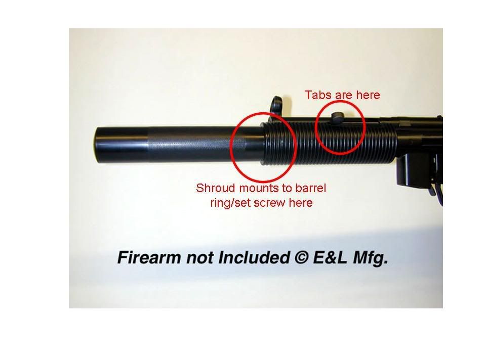

I looked into them a little more. The design that I found attached two ways.
The barrel shroud attached to the barrel with a set screw. This was hidden by the SD cover. The cover fit into the slots on the receiver and had two "press fit" tabs, one on each side at the upper edge near the cocking tube, that pushed through the ribbed cover and were friction-locked into the space between the barrel and the cocking tube.
I do not have this one but this is what I have found on the good old WWW.
I do have a SW5A (in the Pink Carpet pics that everyone loves) that has a barrel shroud that affixes in this same way. I had hoped it was a three lug with a pinned suppressor but it is a full barrel with the set screw fake suppressor. I would thing this is the same deal just dressed up to mock the SD series.
Echo

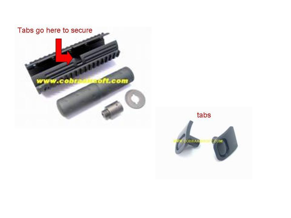

Edit to add pics....
This is a sold out kit from CobraAirsoft but it shows the parts and ideas well....
The ring is sandwiched between the collar and that screws into the suppressor. The barrel slides inside the suppressor. The suppressor shroud is supported on the end by the barrel and the collar on the other. The set screw holds it in place on the barrel.
The ring is used to support the leading edge of the cover on one end, the receiver slots hold the other. The tabs lock in on the top edge and there you have it.... a suppressor-collar-set screw sandwich to support the suppressor, mounting ring and collar add a cover and you get one cool looking, unaltered and full 16" barrel.
I hope this helps
