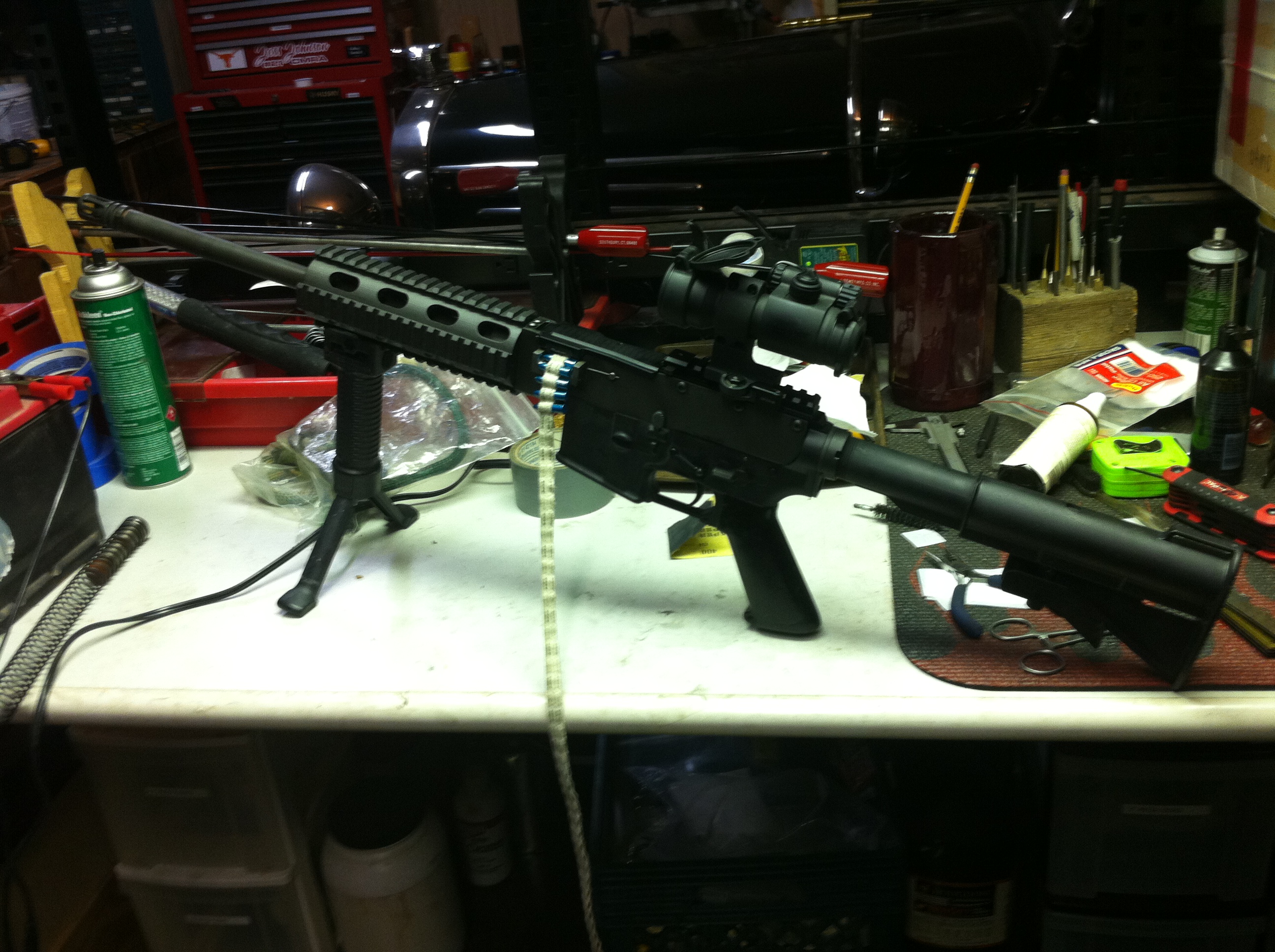

I got mine 2nd hand this week from another member. Timed the sear trip yesterday.. Had to take .050 off of it to get the .020 recommended gap.
Mounted up the comp ml2 on the Larue high mount along with the grip pod.
Manually cycles the dummy rounds great..
Apologies for the messy bench.

raysheen  [Team Member]
7/10/2011 10:04:59 AM EDT
http://www.frenzy.cc/~jester/pics/gun/RB-1.jpg
I really want one of those!
...and that's exactly what a bench in use is supposed to look like!
