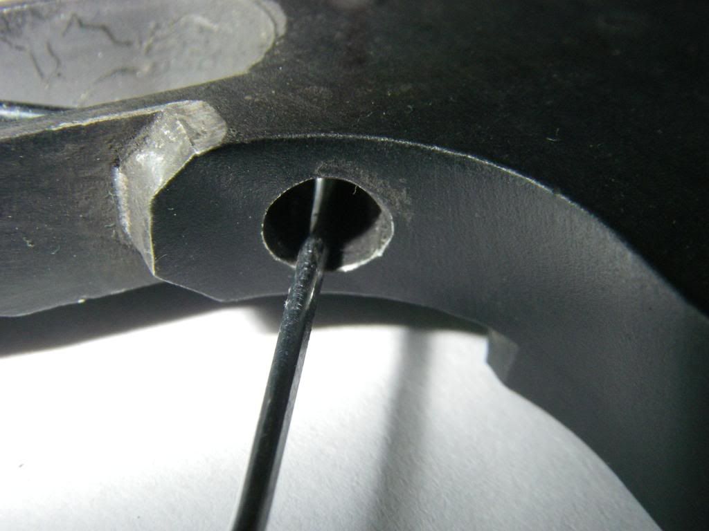

JohnStoner  [Team Member]
3/3/2012 10:59:41 AM
Ar's in 5.56 (18", 16", 11.5", 10.5") 9MM (10.5", 5") 22LR (4.5").
I find the worst blow back is on the short 5.56 and the 22LR.
I like to drill my charging handles (I'm right handed, if you're a left you're boned on this solution). In addition to drilling them I use the RTV sealant solution.
autumnsong  [Team Member]
3/3/2012 11:12:02 AM
http://i277.photobucket.com/albums/kk44/johndsphoto/AR-15%20Collection/HomebrewGBCH3.jpg?t=1317874145
http://i277.photobucket.com/albums/kk44/johndsphoto/AR-15%20Collection/HomebrewGBCH1.jpg?t=1317874145
http://i277.photobucket.com/albums/kk44/johndsphoto/AR-15%20Collection/HomebrewGBCH2.jpg?t=1317874145
Thanks for posting those photos as I have been thinking of trying to do that on a spare CH I have. Looks like a good idea as long as you know you are screwed if you want to transition from side to side.
