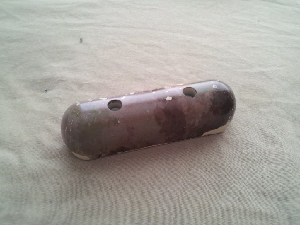

I got my cheek riser done. I think I had some bubbles or something because there's some speckles where the pattern didn't pick up. I think it looks really nice though. It's in the oven baking right now, so I'll get pictures later. Only other problem I had was the pattern split a bit at the hard round edges. I watched a few videos on that so I'm sure it's just my technique. I'm real happy with it though. I just hope I can get the stock right the next go around because then I'm out of film.
Edit 2:
Here it is, fresh out of the oven. I think the speckles may be part of the pattern. It's hard to tell. Either way, I think it turned out nicely. You may be able to see the little tears I was talking about. And on the bottom in the corner on one side, I'm not sure if that's a spot that got missed somehow, or if it too was part of the pattern. There's darker parts of the pattern underneath on the edge and also on the lip on the bottom side.

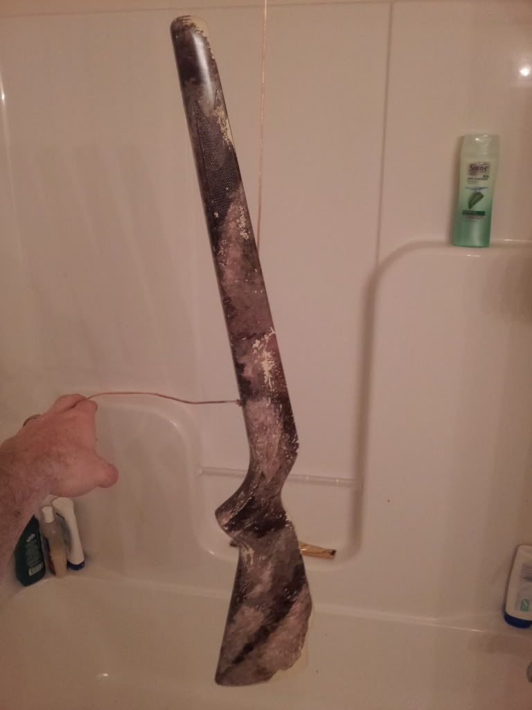

Got the stock done. It turned out pretty decent. For some reason it just didn't cover the top of the rear of the butt stock. But I think it looks ok as is. And since I'm out of film now, I don't have much of a choice now.
The pattern came out a lot darker than I was anticipating, especially since I used an extremely light colored tan (Krylon Almond color.) It's not bad, just darker than I thought it would be.
Stock is in the oven baking right now, so here's a picture of my cell phone case as a teaser for now. The textured look is cause the case was originally a sort of carbon fiber type of look with raised texture. Looks pretty neat now.
Here's the stock hanging to cool off from the bake for clear coating.

i know your excited about your first dip but i would give it another shot. theres a few issues i can see. you need to tape off the voids like the buttstock opening or else the water rushes too fast into the stock before the film has a chance to bite into the base coat. if you can try to get better paint. over the counter spray paints wont work well.ive had limited success with krylon fusion and valspar for pastics in the spray can.if you have a sprayer ive been told to use behr exterior latex with the primer in it.just get a gallon of it mixed up with light tan in color or even off gray or yellow should work as a tint.havent tried it but supposedley the film will still bite into the behr paint weeks after it dries so it makes it very friendly to use.good luck!

Edit: I did have the holes plugged during dipping. Definitely helped I think.
