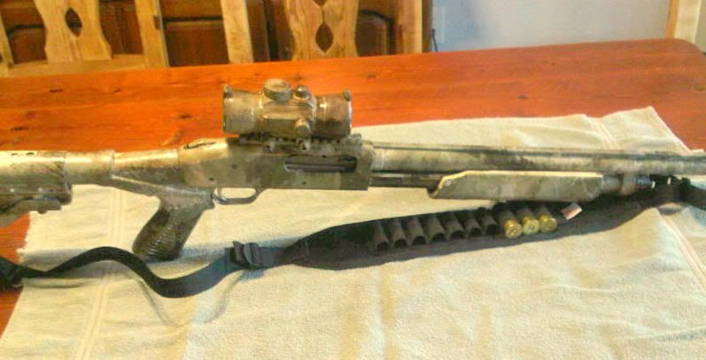

As I said I would. I did some dipping using ATACS Camo pattern.
I stripped down my Coyote 835 Mossy 12ga and dipped it. I did not dip my coyote choke as that goes in the barrel. I guess I could of just taped off the threads but I just chose not to. I bought the ATACS film from TWN and the film is better quality than the ebay film I got in wood grain and predator camo. When I ordered the film from TWN they tried to tell me my activator was not suited to their film and I really needed to use theirs. I passed and just used what I had. It worked just fine with no issues with activation.
The 835 was actually harder than the AR I did mainly because it was a lot dirtier so I had to scrub every part to get it good and clean. My AR was basically clean so cleaning it was easier. I used 220 sand paper to lightly sand the parts. I then I washed it off.
I then sprayed it with adhesion promoter and a clear primer this time. I sprayed the pieces with a tan base coat, This tan paint I was using was much more pale then the other can I had. It was better quality also and I only had a 4oz can of it and ran out when it came tot he red dot. I sprayed the red dot with Krylon Camo tan and it was a darker tan as you can see. It also gives you a good idea how slight changes to the base coat makes changes to the camo look.
During the dip this film from TWN is also slightly thicker and heavier it seems. After I dipped the parts and they dried I put them in the oven at 200F for 45min. When the came out I let them air cool and the film to tough seemed harder. I then applied 2 coats of Marine grade clear coat and one coat of dull clear coat. I then re-assembled it and test fired it.
The rolls you get from TWN are not marked "this side up" for dipping purposes and it does matter. Because I have been messing with this stuff I can tell but an easy way to test if unsure is to cut a small 4x4 section and lay it in the water. If it does not not start hydrating (wrinkling up) you then know to use the other side up when dipping. The wrong side will start oozing a clear film across the water around the edges.

Nice, looks great. Good job. What brand of base coat paint did you use if you don't mind me asking? I am going to be dipping some AR parts this week... Greatly looking forward to it.

That turned out really nice.

You really need some better photos then that! Too bad you're not in IL, I'd have taken care of ya.
