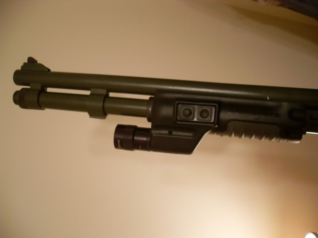

I bought a Mossberg 590A1 today from a guy, and It had a Surefire forend installed on it. After I put a battery in it (which was brand new) , I noticed how dull the light was. So I'm assuming it's below 65 lumens being that it only uses ONE CR123 battery. I tried to switch out the flashlight with my G2 LED .. It was a fail. What do I have to do to get more lumens? Can I buy the flashlights specifically made for that forend? Or am I just stuck with it?

Is it an incandescent light or LED? What model is the light?

That. Not sure the model, looked but couldn't find. It looks like the current model forends, but half the size of the flashlight.
Like this, but not as long.

Is there a part number on the bulb/reflector assembly?
I'm guessing it's a P60 bulb (which is supposed to run off 2 batteries) and the wrong spacer body was installed. You can get an extension the length of a single battery, I used to do that back in the day when converting 2-cell weaponlights to 9v P90 bulbs.

Yeah, A43638. And it is a P60 bulb....So I can buy an extension to solve my problem?
Will this work?

I'm not familiar with that company or that brand, but that looks like it'll work fine. As long as it has internal threads on one end and external threads on the other, and it's the length of a CR123, go for it. A P60 bulb needs two 3v batteries, as you found out it'll illuminate but not well with just one.
[edit:] Did some quick research on that part, yep it'll work.

The 618/623 series uses two batteries. You must have the newer one cell LED version if you can only put one battery in.
You do know that only one batter fits in the forend itself and the other goes into the tube with the lamp?

Mine isn't an LED version, that's the thing. I will post a picture.

That's the older incan version. Can you tell me if the bulb is a p60 bulb?

Yes, it is a P60 incandescent bulb.

You should be able to use an extender. I'd just buy the LED. I have the newer 2 cel incan, but now I use the 618LM series.

If that is the older incandescent I think you are missing part of your light. Someone may have removed the body, sacrificed run time for a "sportier" profile. Your light would be dull because you do not have enough power (voltage, 2 x 3v batteries in serial configuration) to run that particular bulb. It should have two batteries and it is basically a P2 / G2. I have this light on my shotgun and I replaced the incan. bulb with a G2 LED bulb to give better light and longer battery life. I would talk to the person you got the shotgun from and ask for the missing part or contact SureFire and get the missing part. Or maybe you can get a 3v bulb assembly. I could be wrong, M2C YMMV.
As far as run time needed and low light with a weapon mounted light, that is a whole art form in itself. Good on you for training with your gear and running matches that allow you practice these techniques.

Not the best picture, but here is mine...

The extender is the Surefire A19, which you can get from Surefire, Optics Planet or LPS Tactical for about $20

Won't work. Just learned the hard way. Did a little research and the SureFire A12 Lithium Battery Adapter for Classic Universal Gun Light Systems is the one that will fit. The dimensions are different for some reason.
