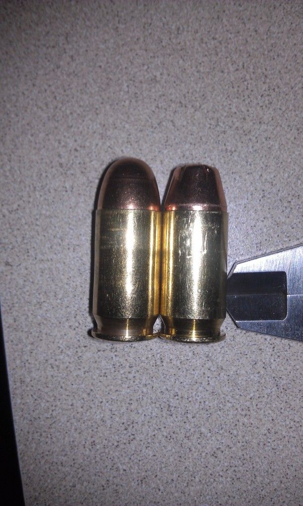

My gun is a SA GI 1911 and I recently purchased Hornady 230gr XTP ammo from Scheels for carrying. I loaded it, slide closes completely, but when I try to rack it to eject the unfired round, it had difflicuty to rack the slide, had to really grip it and yak it back. I took the barrel out, the round will not go in completely just about 1/10th inch sticking out maybe less. I loaded in a reloaded ammo, it goes in perfectly. So i did some measurements between both rounds, and its at 1.218" for the XTP, My reloads measures at 1.266" This is for OAL, measured the cases, bullet, everything is the same except for the OAL and case length. My reload is at .887" while the XTP is at .893"
also the point where the bullet's body starts to cone down, its sticking longer than the FMJ round nose does. So maybe thats the issue?
Should i be concerned and contact Hornady? I have not fired any of those rounds.
Has anyone had the same problems?
EDIT*** Heres a picture, the right one is the XTP

OP, you can see the roughed up ring on the hornady bullet. the diameter is too large i think. the only cure i can think of would be enlarging the chamber slightly and that would not be good for general shooting.

I've shot both the 230 and the 200 XTP's and I could tell immediately from your picture that the bullet was not seated deep enough in the case. In my case, I was loading them so I was able to establish a safe powder charge for seating them deeper. For factory ammo, I would be very hesitant to set them deeper. Call Hornady.
