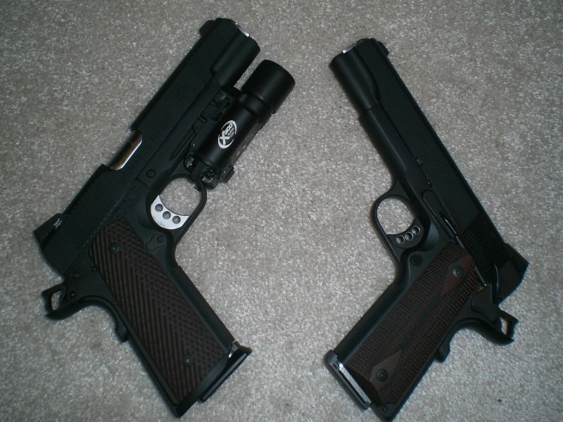

4/1/2012 12:55:45 AM
And the pair.

Excellent set of pistols. Exactly like I like them - all business. Can you post what grips you have on each one?

Thanks, that's what I was going for. They are both VZ dark cherry. Double diamonds on the Mil-Spec and Operators on the Operator.

Those grips look fantastic ... are they all G10 material?

Looks good bud. Now we need the backstory on the MilSpec. What all did you have done, how much, how long.
I might have one of those coming to me that needs that work done to it.

I got more into that gun than the Operator.
All the work was done by the SACS, let me see if I can remember it all.
Wilson Combat trigger, hammer, sear, disconnector, extractor, fps, slide stop, and msh.
SA beavertail and extended safety. They cut in night sights, carry bevel and front checkering at 30lpi. Polished the feed ramp and deburred the internals. Trigger set at 4.5lbs. They tightened the frame to slide fit and installed a NM barrel and bushing. VZ double diamond black cherry and Wilson grip screws.
It took them 12 weeks I love that gun.
IF it ever goes back for a refinish someday, I'll probably have it colt undercut and maybe a Wilson safety. That would be it.
