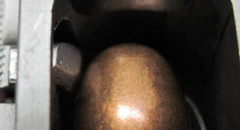

You're not alone... I picked up A Citadel this afternoon, my first 1911, and ran into the same issue. I'm using Winchester 230gr personal protection and 200gr+P Gold Dot JHPs in both Act-Mags that came with the pistol. I think it is a mag issue with mine. As soon as the slide makes contact with the edge of the rim the bullet goes down and into the feed ramp. The extractor does not make contact with the rim. The mags are difficult to unload by hand, they tip nose down with any forward pressure and it feels like there is a snag point when unloading a mag by hand.
This is probably caused by the ammo not laying correctly in the mag. The top bullet in the mag does not lay flat against the round beneath it, instead it is held in place by some half assed spring tension not strong enough to hold the bullet nose up. See picture:
I'm new to 1911s, but that gap/lack of spring support looks to be the possible cause of my problems. Someone let me know if this is a normal condition for a single stack mag, I have never owned anything other than double stack mags, and my double stack mags do not do this. This is just my best guess.
dramsey35  [Team Member]
6/4/2011 7:04:17 PM EDT
my only suggestion is to try a better quality mag and polish not grind the feed ramp.
xd675  [Team Member]
6/6/2011 10:24:18 AM EDT
Picked up a CMC and a Wilson 47D. The CMC feeds the Winchester PP JHPs but balks on the Gold Dots. The Wilson fed both loads without problems. All of my mags fed FMJ without any issues.
RugRat  [Member]
6/6/2011 10:59:16 AM EDT
Kuhnhausen suggests your problem is the result of the magazine releasing the bullet too late. So, slightly widening the lips of the mag to allow bullet to rise sooner is his suggestion. If you start getting stove pipe feeds, you know you've opened the lips too much. Somewhere in the middle, there, is nirvana.
A polished ramp is always a good thing. Grinding on a ramp usually not a good thing.
