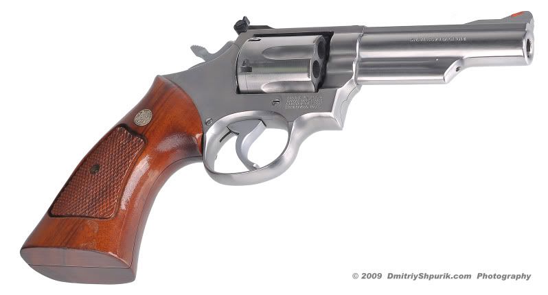

I have seen a 66-2 and love the look, I want more info. However I have found nothing on S&W's website concerning the 66-2. Can you shed some light please?

The 66-2 was made from 82-85. The big difference between a model 66-1 vs a 66-2 is the 66-1 is pinned and recessed. S&W stopped pinning the barrels of their guns and recessing the cylinders of their magnums in 1982. You'll also notice that they moved the S&W logo from the right side of the gun on the 66-1, to the left side on the 66-2.

dfariswheel  [Member]
1/11/2010 12:19:35 PM EDT
Qwertie, I think there may be a misunderstanding here.
The gun you pictured is a S&W Model 66, version 2, commonly called a "dash number".
Whenever S&W makes a design change to a model, they add a version or dash number to the model stamp to indicate the change.
The gun pictured is a Model 66-2, BUT... the actual gun pictured is a rare, limited production 3" barreled model.
S&W made a few very limited runs of the S&W Model 66 with a 3" barrel in dash 2, 3, and 4 versions back in the 1980's and early 90's.
Most Model 66 revolvers had 2 1/2" 4" and 6" barrels. The 3" guns are very rare.
These very rare, limited production models are hard to find and prices are high when you do manage to find one.
Mine is a Dash-3 and was a run of 2500 guns made in the late 80's for Ashland Shooter's Supply and RSR, both big distributors.

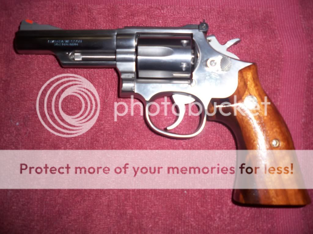

This is my 66-2.
I love "K" frame S&W revolvers.
