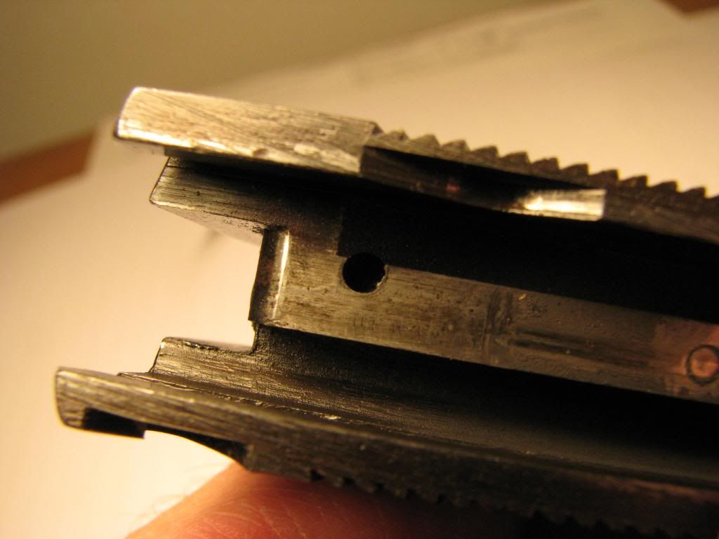

so here's my first question: check out the pictures below, could these trainers be indented too much and effectively causing me to dry fire. i have a floating firing pin, and when you drop the hammer easily, the pin would not stick out of the other end, but obviously when you fired the gun, the pin moved enough to strike primer. so i always assumed i had a floating firing pin. when you use an object to push the pin further into the hammer end of the hole, the pin would protrude about the same distance as the indentation on the trainer rounds. so i wonder if the training rounds allowed the pin to travel too far and hence the breakage. at least thats what i thouught i read or understood to be the problem w dry firing, you allow the pin to go too far too fast and crash inside there somewhere.

found a pin online thru numrich and ordered it. hopefully they really do have it (im seriously in awe if they do). then ill have to fix it. looking at my pics im assuming i need to push out one of the two pins near the rear of the slide (the front most pin is for the extractor), so, which one, and if the rear most, will i need to drift out the rear sight (OH, MAN!!!)? and if i do punch out a pin, do i need to go back in with a new one? cant find the "firing pin retaining pin" anywhere.

NO PIN ! ! !
MISC RETAINING PIN PICS
FRONT ONE FOR THE EXTRACTOR
MIDDLE ONE DOES NOT COME THRU THE TOP SIDE
REAR ONE, MAY HAVE TO REMOVE THE REAR SIGHT ON TOP??

It is called an inertia firing pin, not floating. Some BM's have them and others do not.
I dry fire and use machined aluminum snap caps with a rubber primer area.
The firing pin retaining pin is underneath the rear sight.
Did you remove the magazine safety?

I use A-Zoom snap caps because if you do not use snap caps, you can break either the firing pin, or the firing pin retaining pin.
Take measurements to ensure that the replacement firing pin is an inertial firing pin. If not, take it to a gunsmith and have him dress the firing pin down and fit it.

got a new pin in the mail, and had it all fixed up on saturday, now i need to try it out ASAP to make sure the guy put the rear sight back right, and make sure the pin is working right.
as for the replacement, it seems to be a little longer than the other one, but even so, when i hold the hammer end flush with the slide, it doesnt stick out the breech end. but it is certainly more visible in the hole.
do you think this will be an issue? i.e. too close to the chambered round (i carry cocked and locked, so no issue, but if the hammer were down, would that be ok?)
