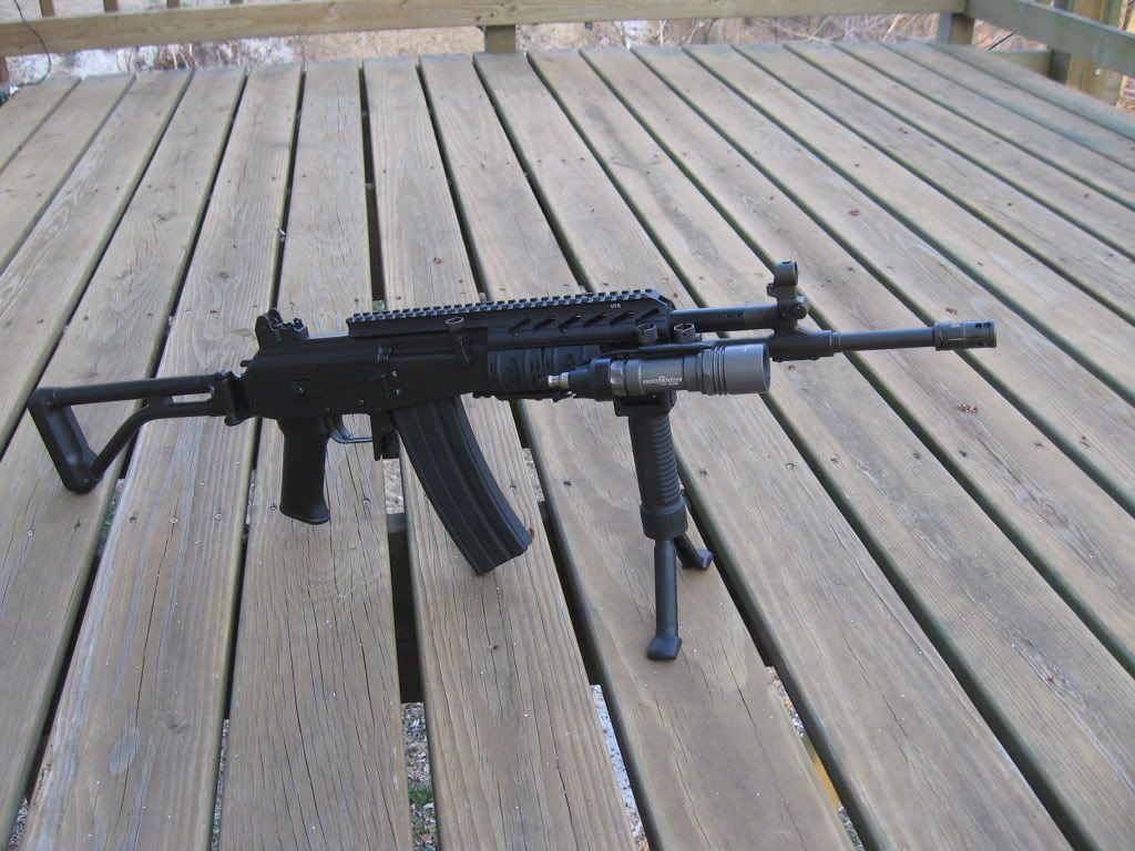

Decent system for the price.
Simple installation too.Attaches (clamps) over the barrel and gas tube for a sung fit(don't over torque)
The one downside is its a tight fit between the cocking knob and the rail.
An easy fix is to swap out the Galil bolt carrier for an AK one.The AK has a horizontal cocking knob -vs- the vertical Galil one.

Wow, that looks really nice. Thanks for the pictures since that topic just came up with Jeff and myself, now I know I will be going with that rail. BTW where did you order your rail?...........thanks.

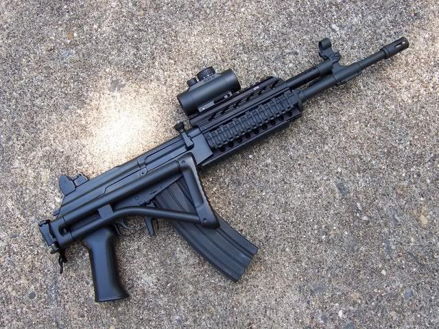

It's aluminum. I cut mine down to save my fingers from being sawed off. I then put the original grip back on, it looks better.

If you look closely at the relation of the cocking knob to the rail, you will notice how close together they are. When I had mine installed, I grabbed the knob to rack the bolt quickly and rubbed the top rail so hard it nearly drew blood from my knuckles. It's fine if you take your time.

I have dremeled and sanded off the sharp finger cutting edge on the UTG rail.
Have tested and does not open fingers. Rail is still too close to charging handle but at least doesnt slice up fingers. If I had better equipment (like a grinder) I could remove more metal and give fingers more room.
Eventually, will hacksaw off rail at 14 and polish up.
