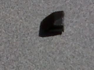

3/21/2011 12:30:25 PM
Here is what is NOT suppose to look like:
Here is the lug that sheared off:
