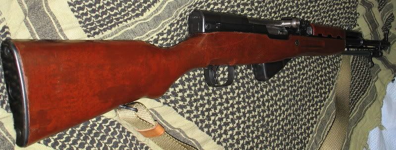

Chinese made from spare parts, the stock is the ChiCom fiberglass "jungle" stock that has been epoxy coated flat black. Tapco 20s run fine in it. Added a "Mojo" rear aperture sight in place of the leaf sight and the metal gas tube handguard (welded it). Was able to tune the trigger to get a decent break.

Originally Posted By simply_green:
http://i37.photobucket.com/albums/e84/Simply_Green/CIMG1929.jpg
Awsome SKS Love mine wouldn't trade it for AK or a 5.56. Out range the AK out punch 5.56 its been proven. Total improvments to my SKS total $400 She redefines EBR in the old skool way. In my hands I know what that rifle and I can do and hey when the shit does hit the fan all that matters is how good you are with what you got. I will be here for years
