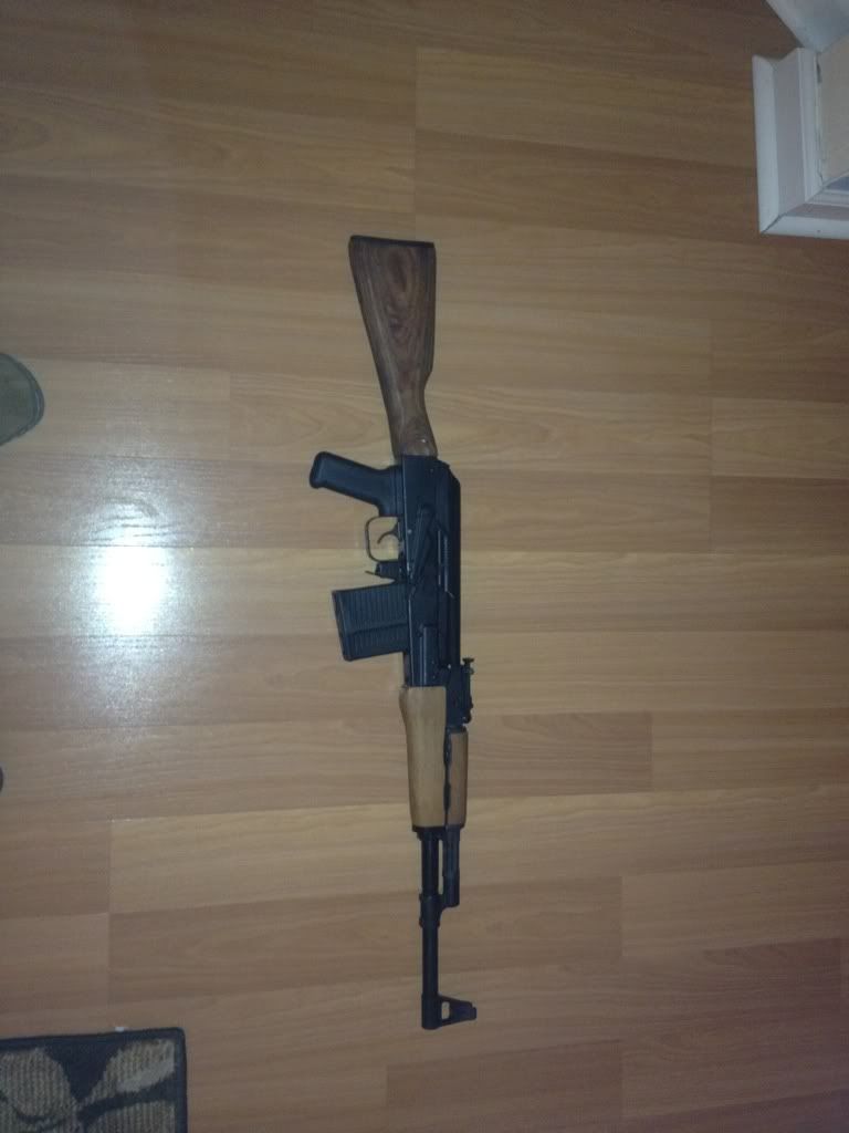

Have not even shot it yet just got done with conversion. G2 trigger Dinzag hg retainer and homemade trigger guard. Can't wait too shoot it!!

Looks good. If I were you, I would also add a threaded FSB with AK-74 style muzzle break.
Dsmturbo44  [Member]
12/27/2011 7:42:41 PM
Will the ak 74 fsb work ?

Looks really good. Nice job. I recently purchased a Saiga .308. Was the conversion hard to do? Also how does the new trigger feel compared to the factory saiga trigger.
Dsmturbo44  [Member]
12/27/2011 8:11:51 PM
Trigger is night and day better. Conversion was easy drill 2 rivets grind 2 spot welds and your golden. You need to grind a little on the g2 trigger but easy to do
kmb147  [Member]
12/27/2011 8:19:50 PM
AK-74 style fsb will work as long as it is for 7.62 caliber
rightwing87  [Member]
12/27/2011 11:21:12 PM
The Saiga 308 barrel is too thick for a standard AK fsb. You'd have to really turn down the barrel diameter for it to work.
Dinzag offers the service to cut the muzzle portion of your 308 fsb so you can thread the barrel.
