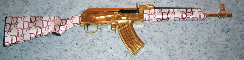

thirtycal  [Member]
11/26/2011 3:46:27 PM
Originally Posted By nictra:
find a cheap enough AK and you will do anything
case in point:
http://i20.photobucket.com/albums/b232/NICTRA/74%20UF/2011-10-12225125.jpg
And another case in point:
-Thirtycal

Killjoy321  [Member]
11/28/2011 5:12:57 PM
http://i182.photobucket.com/albums/x21/clutterbugg/dior.jpg
-Thirtycal
My eyes they burn
