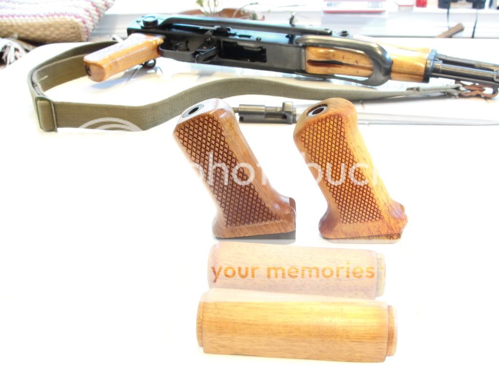

I bought a Galil sidefolder recently and it needed a little TLC. I was raised on a horse farm, and while messing around the old barn the other day I saw a big bottle of iodine on the shelf. Well turns out that iodine thinned with a little isopropyl alcohol makes an almost perfect dye for PolyTech furniture. I don't know if regular iodine works as well but I've got enough of this stuff to last a lifetime. Picture of the newly dyed wood next to brand new PolyTech set. I'm not finished with this set yet but I'm sure it's going to turn out just as close as I need. I just thought I'd share this for anyone wanting to refinish their Chinese wood., , ,

3/30/2010 10:27:54 AM
that looks pretty close. i always wondered how they got that honey color. thanks for the tip.

Originally Posted By JacksBlackToys:
I bought a Galil sidefolder recently and it needed a little TLC. I was raised on a horse farm, and while messing around the old barn the other day I saw a big bottle of iodine on the shelf. Well turns out that iodine thinned with a little isopropyl alcohol makes an almost perfect dye for PolyTech furniture. I don't know if regular iodine works as well but I've got enough of this stuff to last a lifetime. Picture of the newly dyed wood next to brand new PolyTech set. I'm not finished with this set yet but I'm sure it's going to turn out just as close as I need. I just thought I'd share this for anyone wanting to refinish their Chinese wood., http://i696.photobucket.com/albums/vv324/JacksBlackToys/AKs/DSC00895.jpg, http://i696.photobucket.com/albums/vv324/JacksBlackToys/AKs/DSC00894.jpg,http://i696.photobucket.com/albums/vv324/JacksBlackToys/AKs/DSC00894-1.jpg
Looks damn good. How many parts of iodine to alcohol if you don't mind me asking?
JacksBlackToys  [Team Member]
3/30/2010 3:46:44 PM
Looks damn good. How many parts of iodine to alcohol if you don't mind me asking?[/quote]
I don't know I used about an ounce of alcohol and just kept adding iodine until it looked dark enough. Sorry, I'm sure thats not the answer your looking for.
