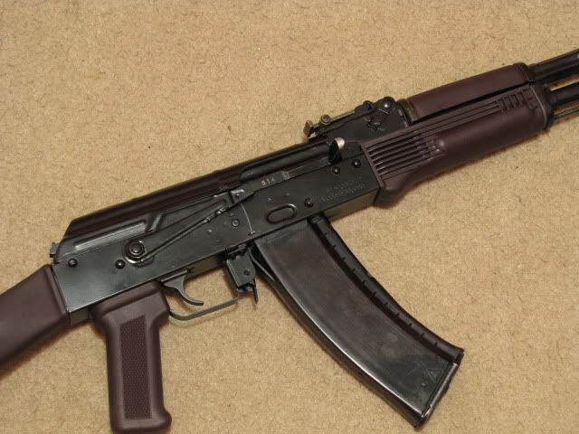

I painted my TGI74 with some duplicolor gloss engine paint.
My cable and internet is still down due to all the flooding in Nashville, or I would post a pic. Turned out nice and has held up to a few cleanings.
Really makes it a different rifle. I think I have a picture in the plum party thread, pretty recent if I recall.
Whatever you use, take your time and do light coats.

Finslayer83  [Team Member]
5/5/2010 2:01:02 PM EDT
Dupli color engine paint, can't remember if it was ford or chevy low gloss.
everything was painted besides the BCG
5/6/2010 2:43:15 PM EDT
It's whats on my TGi-74
Shot once in a downpour, no issues.
Around 700 rounds through it since it's paint job, holding up just fine to three cleanings with water + hoppes #9 + Breakfree LP, no issues.
Best part about it, its less than 10 bucks and you can touch it up if it were to wear off.
I degreased the metal with brake cleaner and let it dry. Took a heat gun on the medium setting and would go over the gun a few times till warm/hot to the touch, then painted.
Dried fast, works great.
