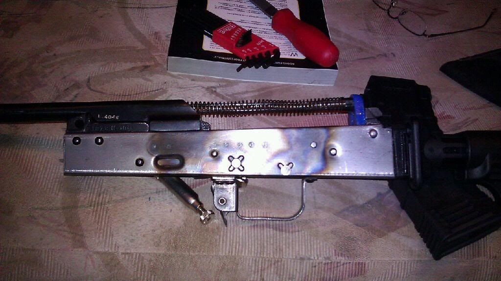

Got around to spot welding my rail on my P/U folder....
H/F 110 spot welder....Been used 3 times.
AK spot welding tong is a MUST! in my book.
1/4in drill bit for the left side, and 15/64 for the right.
My 1st build.....
Took 9months to build..........But it shoot like a dream....My son shoots it more then the AR..

I get less crap from my guns than from my children.... I wish it took me a month or more to build one.... In a week I have one built and only a couple of hours every day... Dammit I have to make more kids they take longer. Nahhhhh guns are easier to afford. Only thing I can stress on using the spot welder is sand and clean the contact points before each use and order an extra lower tang or screw contact point since that is the only part that wears out......and depending on your welder it takes about three to five seconds or counts per weld.

cause one rail sits higher than the other.
