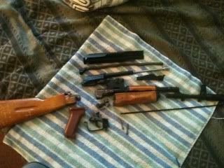

Alright thank you everybody. I havent had the time to even touch my ak yet. but what im planning on doing is getting a dremel to flatten or even concave the rivet head, and using a "anti-walking" bit to start it, then drilling out the core and punching the rest out. i didnt know that you were supposed to press out the demilled barrel pieces before removing the rivets though. so that is good to know. i figured that if you got the rivets out first it would be easier to press out the barrel pieces. but here is my parts kit.
