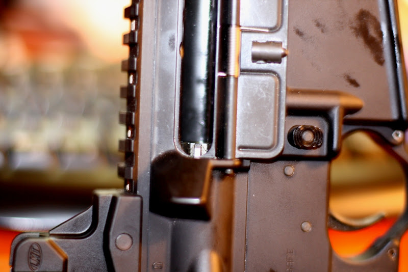

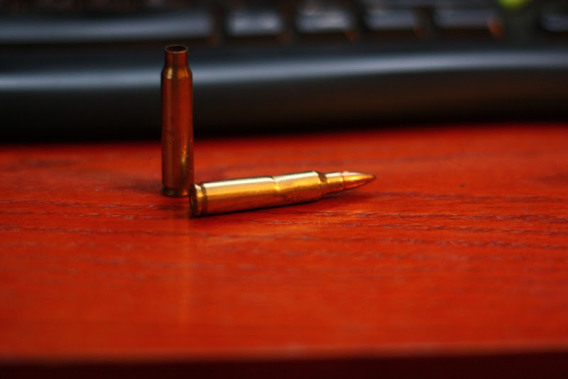

The stove pipe is as follows: The spent shell casing will extract from the chamber, kick 90* and get wedged into the ejector port as the bolt feeds the next round from the magazine. The result is that the spent shell casing is not fully ejected, and the new round is only 1/4 -> 1/2 way into the chamber. Since the bolt is forcing the new round in and compressing the two cases together the old shell casing actually deformed the new casing. The issue seems to be sporadic but occurring between 2-3 times per 30rnd magazine.
Here are some pictures of what I am trying to explain:
Stovepipe
From underneath:
Mock up of jam:
Bent shell casing:
Since this has been happening I have been to range about 5 or 6 times, trying to diagnose this problem. I am using a variety of magazines (USGI, 20 & 30rnd PMAGs which all function well in other ARs) with mainly American Eagle 55gr FMJ. (I have also run Fiocchi and Winchester through with no change). At this point this rifle has ~1000 rounds down the tube and has been cleaned and lubed after every range trip.
