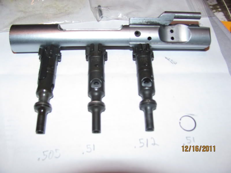

AMUshooter10  [Team Member]
12/16/2011 5:21:37 PM
Ok I don't know if this helps but here is 3 different manufacturers and they all work.
1st is .505 2nd is .51 3rd is .512 and the ring alone (mil-spec) is .51 nearest I can measure.
