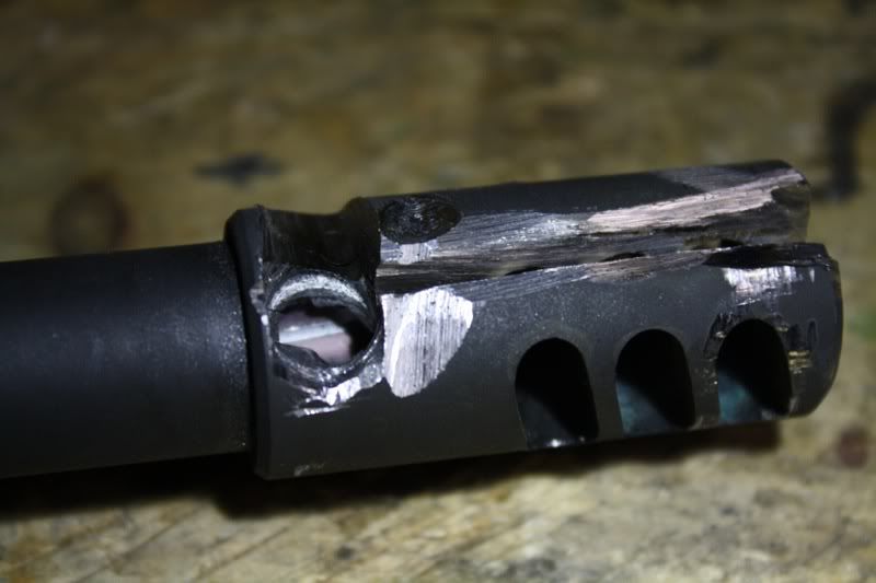

n2wilderness  [Member]
3/10/2012 9:23:30 PM
I screwed up
I was trying to take off the muzzle brake with the drill press method and ended up drilling too big of a hole in the threads and I still can't get the muzzle brake off.
Is my only option to have someone cut the barrel to 14.1" and put an extended comp/flash suppressor to meet the 16" length?
Here's a picture of the beauty.
DaveS  [Team Member]
3/10/2012 9:40:13 PM
Originally Posted By n2wilderness:
I screwed up
No. You should be able to have someone do the split and pry method along with cleaning up the threads.
Send this to ADCO http://adcofirearms.com and see what Steve has to say:
I screwed up
http://i66.photobucket.com/albums/h280/tiiiw/f63fdfd1.jpg
See, that's what you get for not listening and just leaving it on.

I ended up getting it off but the hole in the barrel is to big to keep the accuracy the way I would want it (do you agree?). It looks like I'll need to cut and re-thread.
Slash  [Dealer]
3/11/2012 6:46:04 PM
http://i66.photobucket.com/albums/h280/tiiiw/325277c8.jpg
I can fix it, and I wont even charge you extra for goobering it up.

uglygun  [Member]
3/11/2012 11:08:34 PM
The next step is for me to deal with the muzzle brake. Dave sent me a link to the split and pry method which is one option. I was wondering if it would also work to use my drill press on the welded pin area as long as I'm careful not to go too deep. Would that break it loose?
I did mine back in 1994 with a grinding wheel. I located the pin and was able to grind the weld loose on two sides of the pin. I was able to save/spare my muzzle brake though it's got an ugly grind mark through the bottom of it.
I managed to find a die to chase the original threads on the barrel and clean them up a tad for the vortex I put on it.
/edit major edit...
Posted my response before reading the rest of the thread.
YIKES!
Next time, please use more caution and based on this experience do more research into what you are looking to learn and what you are looking to do.
For what it is worth, my pin in my muzzle brake was installed across the threads such that it bisected or made a tangent contact to the surface of the barrel threads. If I hadn't used a grinding wheel and gone slowly I would have never seen the dissimilar metals and the hairline gaps showing the direction of the pin as it crossed the barrel threads and contacted the barrel. Truth is I was able to grind the pin out without ever coming in contact with barrel threads, once the weld was broken on the pin/flash suppressor I was able to pry the pin loose.
This wasn't a pin that is installed similarly to what you would see holding a barrel extension onto the barrel for installing/locating into the upper receiver.
