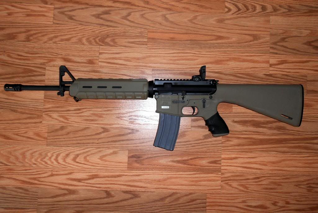

mrs50sls56  [Member]
4/8/2013 2:05:21 PM EDT
This is a simple solution; not super light, but not super expensive either. GWACS lower, 16" LW Mid BCM. MBUS. MOE.
matt2k12  [Member]
4/8/2013 2:58:26 PM EDT
Looking good. And I would even go with a 14" and muzzle device for more weight savings. I am just imagining that thing on a sling while hunting deer or other game and creeping thru the brush. My current hunting rifle is a heavy beast.
