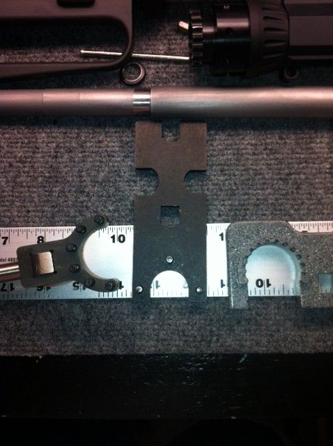

Here are three barrel wrenches I use, although I won't claim any one is the best.
The left one is from Rainer (I think), it's advantages are it hooks directly to a torque wrench and has numerous prongs that don't slip. It is strong and it is my preferred barrel wrench.
The middle one is a USGI type. It works well, but I've noticed with really tight barrel nuts the three prongs will flex, slip and I have broken teeth with it. I think the prongs have stretched allowing too much play.
The last is a typical multi wrench. It holds well because it engages a lot of the nut's teeth. This type is better for me than the ones with three prongs because of their tendency to break teeth.
For a castle nut wrench I use the Spikes most often, but the Hammerhead looks to be an improved wrench for this purpose. For muzzle devices I use a 3/4" open end wrench.
