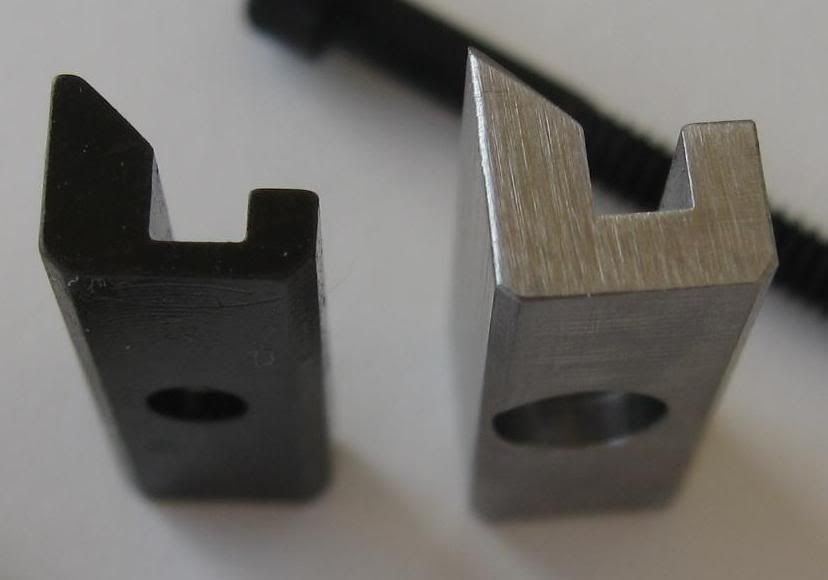

The good folks at Battle Arms Development send me a replacement mounting clamp for the MaTech BUIS to T/E.
Here it is and the package it comes in.
as you can see in this pic, the Replacement (on left) compared to the OEM unit that comes with the Matech (On right) is much beefier. The big issue with the OEM unit was that lots of folks and Joes were busting them by over tightening. Mostly due to not being smart enough to RTFM (Read the F*&king manual)
But also due to not making the clamp thick enough to prevent your average snuffy from doing that. The clamp appears to be well made.
Here it is mounted. The clamp is countersunk to keep the cap screw head from sticking out like the original clamp. I reefed (technical term) on the 7/64 allen head screw and it mounted securely with no issues.
I like the MaTech BUIS. It's not the best, and it has a few flaws (Staked area that holds down the spring loaded sight wears causing it to pop up , Clamp breaks, Aperture too small. ) but the aperture can be drilled open, the stake can be re done and now the clamp issue is resolved. The sights can be had for under $50 and I like steel over Plastic on something designed to be used as a sighting system for a weapon.
If you have one and suffer from a broken clamp.. now you have an option....

Here's a pic that shows the new clamp's significant increase in thickness

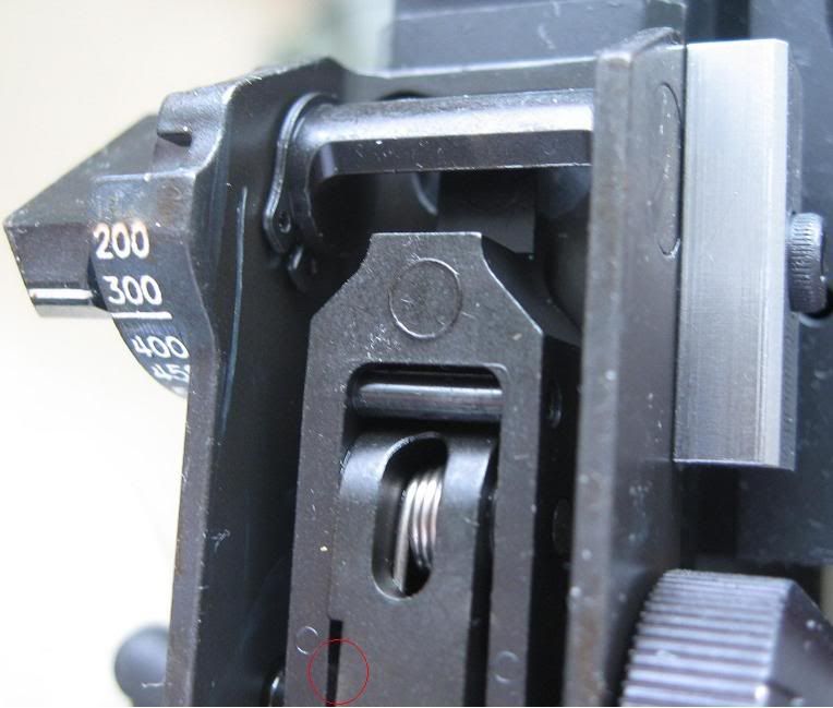

Give me some time and I will post some pics. The short answer is to use a drift punch or the field expedient equivalent and hit the spot that has extra metal sticking out (the part that holds the spring loaded aperture from popping up) What your doing is displacing some more metal to replace what wore down.
Duffy  [Team Member]
1/2/2010 5:59:32 AM EDT
It's the little protrusion on the left, inside of the sight stalk housing (not the main housing, but the one that moves up and down with the windage adjustment)
See red circle. All of my Matechs are on loan or I'd take a pic or two, this is the closest I can find

The difference between the LWRC replacement kit and the retrofit kit is a qualitative one, in terms of costs, LWRC actually costs more ($18 plus $17 or so for shipping, vs. $25 shipped)
LWRC's replacements are the same bracket and screws that ship with the sight. I reckon once someone overtorques the screw and breaks it, he'd learn not to do so again, this doesn't change that the screw isn't as robust as it should be, and the bracket is still the same thin clamp.
There are two reasons the recoil screw tends to break while the sight is installed:
1. The oversized Allen head is mated to a rather small diameter screw body, this isn't a good combination, as one can exert more torque with a bigger wrench.
2. The strength of the recoil screw is underwhelming. 30Lbs/Inch of torque is enough to snap the factory screw in two.
The retrofit kit's screw is the same grade as the screws used on AR15/M16 carrier gas keys, it's s much better quality screw. The clamp is cut and machined from a bar stock, its shape and location of the screw hole have been changed to better allow the sight sitting square on the receiver when mounted.
Then there's the issue of AFTER the sight's mounted. If the rifle were to fall and and landed on the concrete with the sight taking some of the force, a stronger recoil screw and bracket will only help the sight survive the drop.
