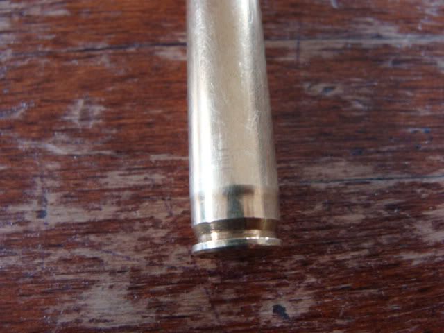

I have been shooting pmc full metal jacket 55 grain out of my bushmaster predator 1/8 twist 20" barrel and it doesn't shoot all that great and I've noticed that after about 300 rounds the last 1/4" of the brass case at the end towards the primer is bulging slightly on the fired cases. I looked in the chamber and noticed there was some brass flakes in there so I cleaned them out, do you guys think that bulging was just from the case not seating fully in the chamber or is that slight bulging normal. Also should I be shooting heavier bullets out of that twist and if thats true what weitght has worked well for you guys out of the 1/8 twist rifles thats fairly cost affective.

It just doesn't group very well it cycles fine. here are the pics, I think i described it somewhat incorrectly its more of a ridge that steps down at the end but there is definately a ridge that you can feel and see.
KBAD  [Team Member]
4/15/2012 12:46:41 PM
Not normal. I would stop shooting that rifle and figure out what's going on.
Looks like an out of spec chamber

Originally Posted By mustang-cars:
Ok so what do I do about that. I'm the original purchaser of it new. Should I just go through bushmasters customer service I suppose. And I should say that they don't all look this bad but that is definately the worst one out of the 80 or so rounds I shot yesterday. Thanks
I'd contact BM and see what they say. Those cases should not be bulging like that in a spec chamber.

I have almost all of the spent brass since firing this gun new and I just went and checked it out, it all has a slight ridge that you can feel when running your fingers over the brass its just not as bad as the one in the pictures.

Yeah I looked in the chamber last night and I saw some light scratches at the top of the chamber length wise like it was rubbing more there possibly when the round was going in or out. Nothing else seemed wrong.
WI57  [Team Member]
4/15/2012 1:12:35 PM
STOP SHOOTING!
Some how you have an oversized chamber, you are lucky you haven't blown your rifle up yet.
Either the chamber was cut way to big or someone got in there and polished too much material away.
Contact bushmaster if nobody worked on that rifle, if you had work done take it back to the place that did it.

Is it possible for this to happen if the round wasn't seating properly because the chamber was dirty or would it not even fire if it wasn't seating all the way.
WI57  [Team Member]
4/15/2012 5:20:01 PM
If the round is not seated the bolt can't rotate enough for the firing pin to protrude enough to fire the round.
The majority of the time damage like what happened to your rifle was caused by someone lapping or polishing the chamber and getting carried away.
Then they remove too much material and when you fire the brass has to swell up further to seal the chamber.
If you get an extra soft or hard brass it may not swell and might just tear and then the gas vents out the rear of the chamber into the receivers.
Bingo - that's exactly what I was going to post as well. Out-of-spec chamber is my primary guess.

That's a bit too much swell. The chamber is too big or the brass is too small. You can measure the brass and see if the chamber is towards the big side, you might have to do a little trig to get the number at that point on the case.

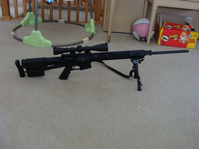

5/14/2012 9:10:04 PM
The gun came back today. They rechamfered the muzzle crown and it looks like s**t you can feel the rough nicks in the metal at the crown. They polished the chamber. I also complained about the loosness of the upper to lower fit which I know doesn't really matter, so the put an accuwedge in there. What is the yellow deal by the way. I am most unhappy with the muzzle rechamfering I think it will be less accurate now what do you guys think.

Yellow thing is a chamber flag
