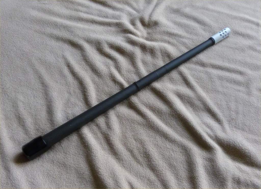

I figured I'd post on this thread since this is the barrel I'm going to use with the Osprey kit I ordered, and it's not that remarkable anyway.
Fooling around in the shop today, I whipped up this compensator (at least I hope it ends up being compensatory).
I have some free machining stainless showing up tomorrow but this is just an aluminum prototype.
The ports are angled 5 degrees forward. In theory they should be angled backwards to get more muzzle brake effect but I don't want to be directing gases back towards the guys using adjacent shooting tables.
My brother in law told me about the time he shot a Barrett Light 50 with a muzzle brake and it did not go well for the shooters set up around him.
They pretty much cleared off several benches to either side of him.
Not that I think 5.56 can do the same thing but I'm proceeding cautiously.
I will do some back to back testing once I get the upper assembled.
