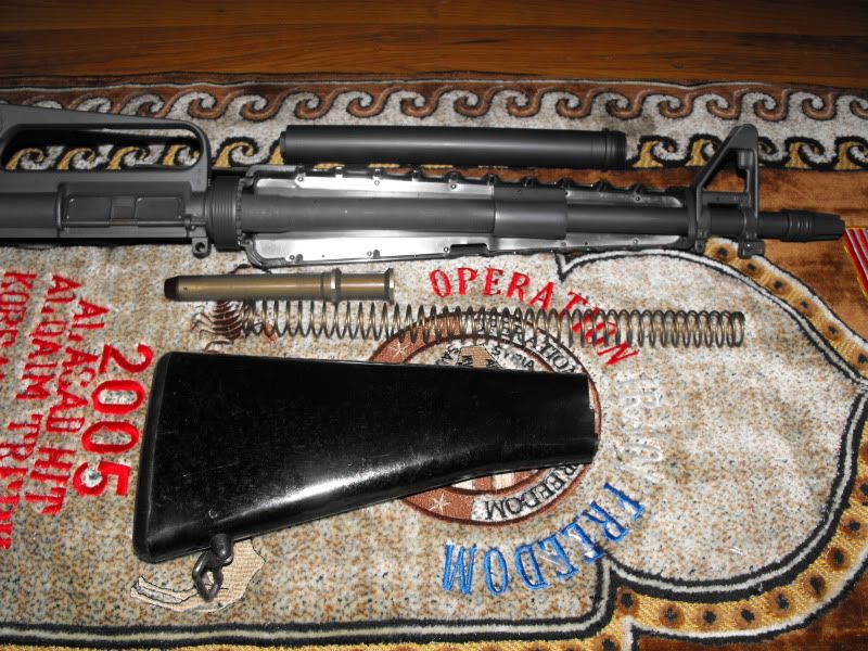

Not meaning to steal the thread, but, the OP may end up with the same questions. I,m putting together my version of a 605 on the "cheapo" with my spare parts. It has a 16" carbine barrel, and carbine gas tube. Do i have to use a carbine buffer and carbine buffer spring, with some kind of spacer in the type D stock? or can i use a rifle length spring and buffer as in the pic?

Not meaning to steal the thread, but, the OP may end up with the same questions. I,m putting together my version of a 605 on the "cheapo" with my spare parts. It has a 16" carbine barrel, and carbine gas tube. Do i have to use a carbine buffer and carbine buffer spring, with some kind of spacer in the type D stock? or can i use a rifle length spring and buffer as in the pic? http://i97.photobucket.com/albums/l216/gordog_2006/605underhand-guard.jpg

you can run a carbine upper/barrel w/ a fixed stock. you just want to make sure you use the correct spring/buffer w/ the correct tube/receiver extension.
gordog  [Member]
5/3/2012 7:10:10 PM
Thanks for the repy boywonder, but, i,m a little confused. You say the correct buffer and buffer tube? Well, that is my question. What would be the correct buffer and buffer tube? What i have in the pic is a standard rifle tube and a standard rifle buffer. Would that be OK? or am i missing something?
boywonder777  [Team Member]
5/3/2012 7:35:11 PM
what you have in the pic will work.
by correct buffer/spring to the tube i mean:
rifle length spring and buffer for buffer tubes (fixed a1/a2 stocks)
carbine length spring and buffer for receiver extension (collapsible stocks)
they are not cross compatible. a carbine buffer in a rifle length system may cause damage to the lower parts as it has a lot more travel at the end and more momentum going forward. a rifle buffer in a carbine may not cycle as the bolt carrier can't complete the full rearward travel as the rifle buffer is longer.
