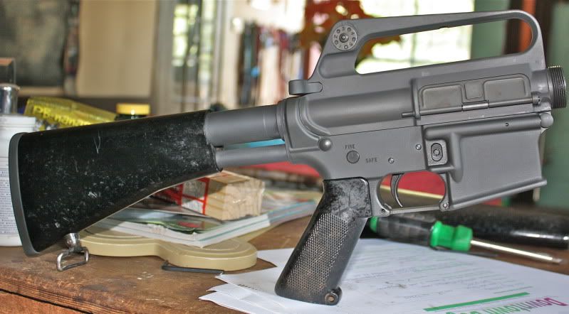

Hey cohrs, wish i had a better pic of the 605ish i,m working on. Isnt the ceracote a moly resin finish, similar to John Norrells moly-resin? I,ve used the Norrells on all of the steel parts and the upper and lower with no problem. The color is lighter than the XM Gray, but, i still like it. Why cant you use your cerekote on the upper and lower? This pic of the lower rifle is not as light as it appears, (must be the flash) Good luck.

Hey cohrs, wish i had a better pic of the 605ish i,m working on. Isnt the ceracote a moly resin finish, similar to John Norrells moly-resin? I,ve used the Norrells on all of the steel parts and the upper and lower with no problem. The color is lighter than the XM Gray, but, i still like it. Why cant you use your cerekote on the upper and lower? This pic of the lower rifle is not as light as it appears, (must be the flash) Good luck.http://i97.photobucket.com/albums/l216/gordog_2006/6052.jpg
Don't know if it is just the glare but that seems alot lighter than the pictures I posted? Is it really that light?

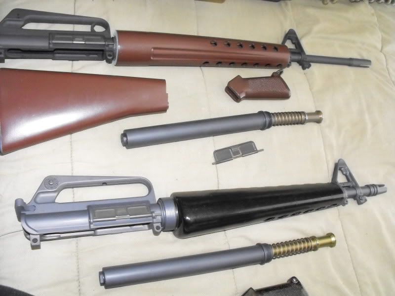

I really like Cerakote. I'm also working on a 605 that will be used as a blaster, so I want a tough finish that is also close to XM grey. Here's an XM177E2 I'm working on next to a Colt SP-1 upper:
You can make the shade darker with Graphite black cerakote, but I really like the receivers on the more grey side. You can also add that tint of OD green that many receivers had in the Vietnam Era.
http://i1085.photobucket.com/albums/j422/LRRPF52/DSCF0001.jpg

LRRPF52  [Team Member]
4/20/2012 12:32:29 PM
I see it clearly displayed ike the others. Are you on a hand-held, or PC/Laptop?
That Norell's does look good.
